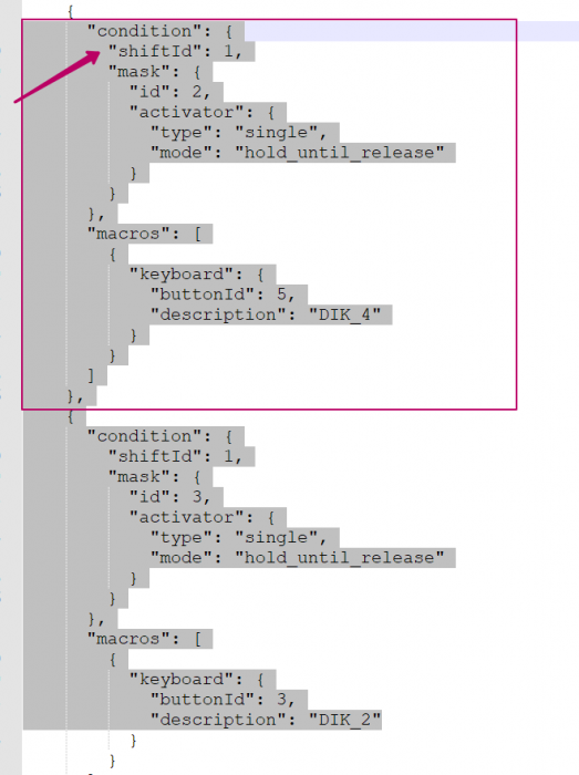

    If you go into the config file, you can find all the nodes that are used in the Shift, but that may not be that easy.
    You can try to find all nodes with "ShiftId" and copy the whole block (both "condition" and "macros"). Shift modifier is set separately, at the beginning of the file.

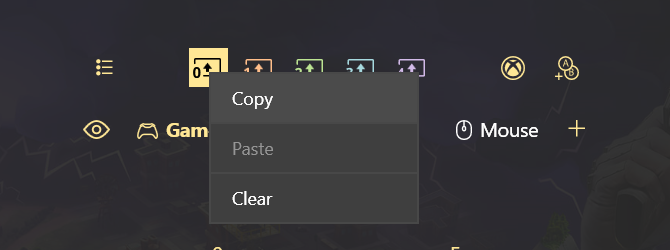

        Now you don't need to copy and paste Shift mappings manually, this option was added to the GUI.
        Please check the context menu here to try it:

        Small note: you will need to add a Shift modifier for each Shift, it is not copied with this option.
