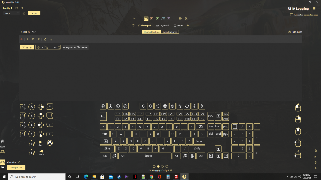

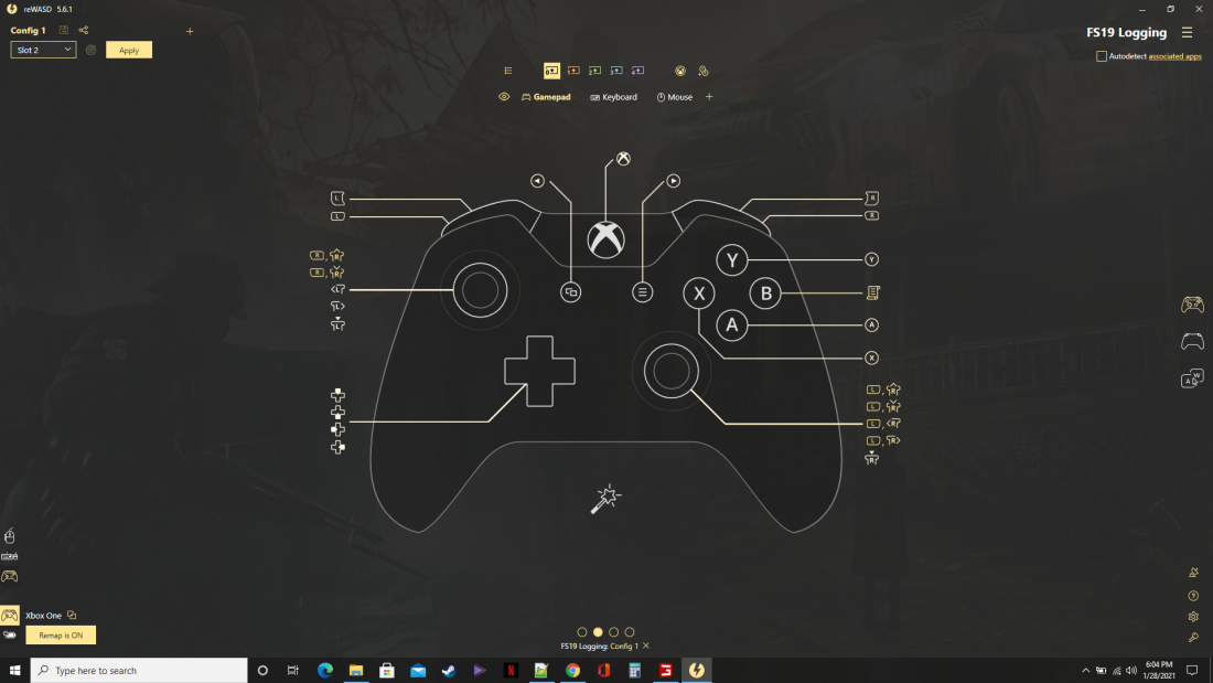

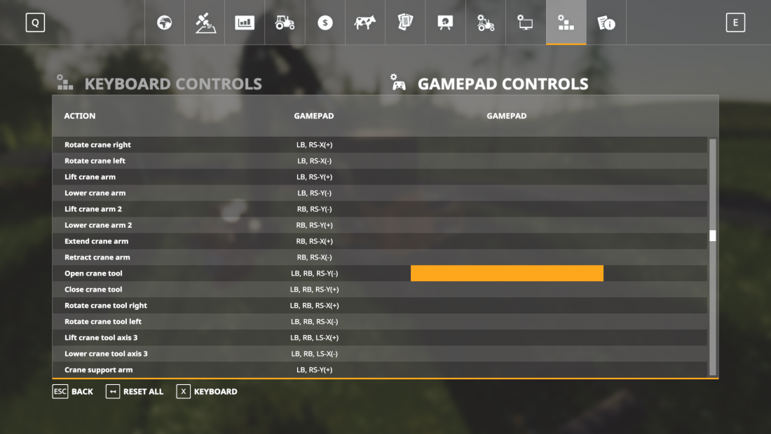

Hopefully the screenshots will shed some light on the subject. What I mean by "flow" is the two sticks have to work in concert with one another. What I came up with would compare to a FPS game where you are using the left stick to move and the right to aim. It would be like having to stop, change direction, go, stop, change your aim, fire, then go. You'd be dead right there. LOL. The standard controls for the farm game make you hit LB and right stick for one boom and then RB+LB+stick for another axis. For it to work right it needs to happen without the LB or RB inputs. I can change these in the setup of the game, but then you have to change a ton of other ones so they don't fight each other. It sort of works, but the standard setup for the rest of the game works great as is.
I got reWASD so I could setup both ways and just switch between them as I changed machines. Hopefully I'm not barking up the wrong tree. Maybe it's just too complicated for my old brain. I usually catch on to stuff like this pretty easy but this has me baffled.

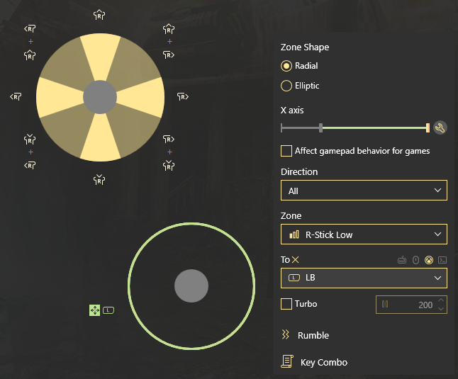

Though I notice you have strange mapping on sticks. I think they should be replaced with [Shortcuts] or [Zone mappings]. That way you'll be able to keep the accuracy of the stick deflections.
For example, go to [Advanced] settings of right stick and stretch [Low Zone] to the maximum. Then set [LB] mapping to [R-Stick Low] in [All] directions. Should look similar to this:

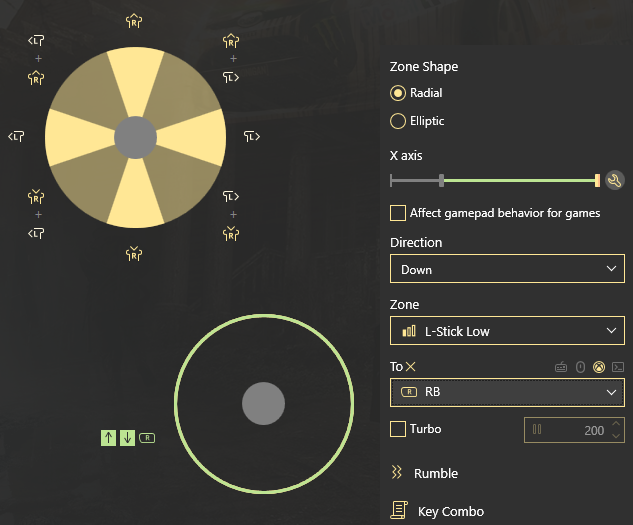

For left stick, map [Up] and [Down] to [Right stick Up] and [Right stick Down], then do the same thing on its [Advanced] page, yet set [RB] mapping only for [Up] and [Down] directions:
