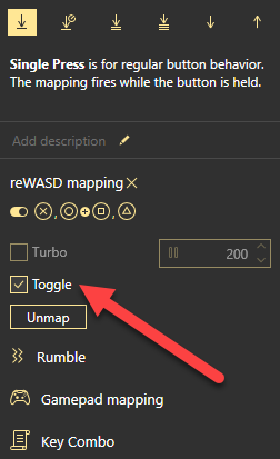

    Just enable a [Toggle] flag for that [Combo]. You'd need [Rapid fire] feature for that. Also check if you have any unnecessary pauses at the end of your [Combo].

      sorry i dont understand what you mean by just enable [toggle] flag foe that combo, sorry im new to all this, also i bought the whole package so i have rapid fire too. i'll have a look at the end for any pauses. now thanks
        It's this thing:

        Once enabled, whatever you've mapped to that button will repeat until you tap the button again.
          Ah brilliant thank you , I’ll give it a try and see how it goes.

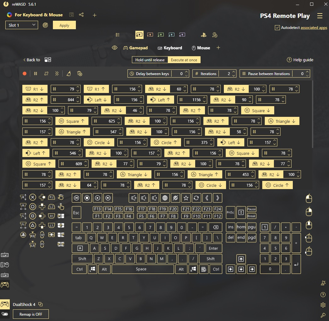

            Hello! The gap between iterations may be caused by the combo itself. I do not see your combo fully, so could you please ensure that you do not have pause or rumble at the end?
              I have a similar problem.
              I am using the newest version of the software.
              I want to have an endless loop of my combo or have it repeated 500x times.
              I recorded a combo for my gamepad for remote play on PS4. It works. But if I select Iterations: 500 and pause in between 2500 ms or 250 ms it does not get repeated. The whole combo only plays once.
              If I activate the “toggle” button for the button it also only repeats once.

                  I found the error, I think.
                  It seems like I have to press save to make it work.
                  It’s just counterintuitive as the macro / combo I recorded did not need this to work. And the macro worked right away.
                  The program seems great, but the UI is - for me personally - a nightmare unfortunately.
                    You need to reapply the config after each change for the changes to take effect. It's not necessary to save the config before applying it.
