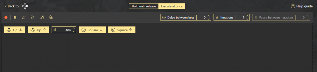

    So i am trying to use macros to manipulate combos in a game via Remote Play. I have assigned the Right D-Pad on my DS4 for macros and made a macro. Whenever i try to use the macro by pressing the Right D-Pad on Remote Play it does nothing. The macro i have created does not replicate. Additionally the Right D-Pad itself loses functionality in the game. So i know the macro is doing something but its not working. Any help?

      Im trying a simple combo and its not registering. I've opened joy.cpl and whenever i press the Right D-Pad with macro enabled it does not pick it up. With the macro disabled it works perfectly fine. Let me know if you need a video. Click image for larger version

        It's working, but too fast and the game ignore these inputs. Please, try to add 20 or 30 ms delay between keys, like this (screenshot).
