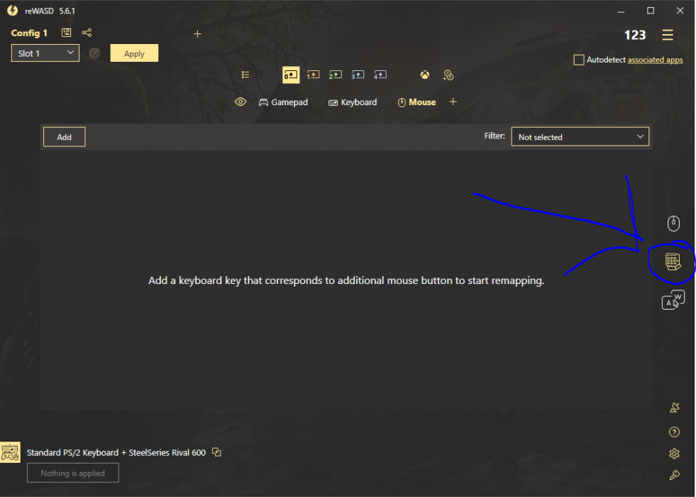

    Try using the additional mouse buttons section.
