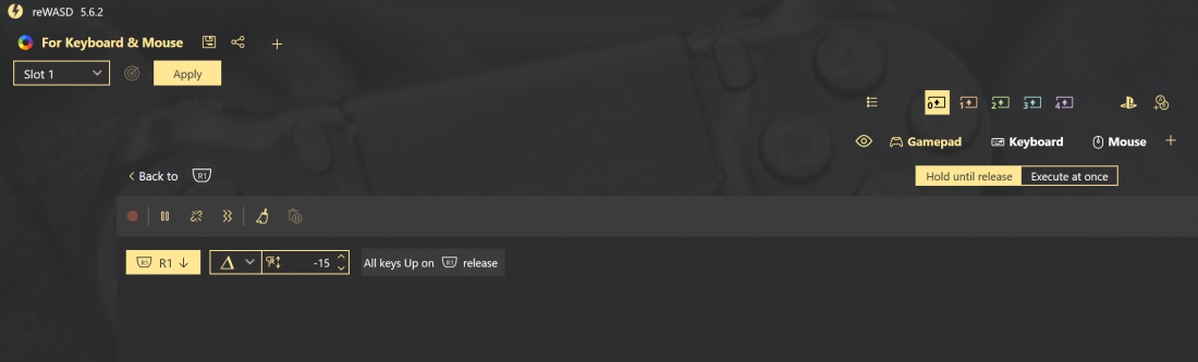

    Every time i press R1 i not only want to trigger the d-pad up twice (mark enemy) but also to pull the right stick down a little bit (recoil reduction).
    The problem is that i have to put the recoil reduction in the "Hold until release" categorie and the d-pad up twice in the "Execute at once" because it is not possible to put the same button twice in the "Hold until release" categorie.
    I put them all under "Single Press".
    My "Hold until release" should look like this:

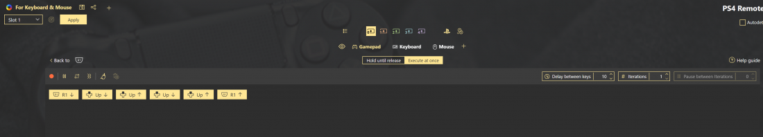

    ...and my "Execute at once" should look like this:
    As soon as i click "Execute at once", the Key combos get transferd into the "Hold until release" Tab and they do not stay or work simultaneously.

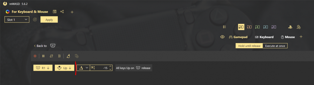

            I have another idea.
            Try to set a long pause before the RT release (screenshot). Use the "Execute at once" mode and don't forget to set a turbo option. Try to adjust the pause value in combo the way you need.
              Doesn't work either, it just keeps shooting the gun for 6 seconds and there is no way to stop it.
              I guess i just have to wait some time, maybe there will be a implementation for this at some point in the future
              Thank you very much for your Help
                Could you please re-check whether you have Turbo checked? With this option, the combo stops when you release the button with a Turbo. You can add a bigger pause if you press and hold this button longer. However, Turbo option requires Rapid Fire feature. Is it on (has trial days left or is purchased)?
                  My mistake, it worked with the turbo checked (yes i purchased the whole programm with all features).
                  Ok so far the d-pad up twice and the right stick down are working like a charm, thank you very much

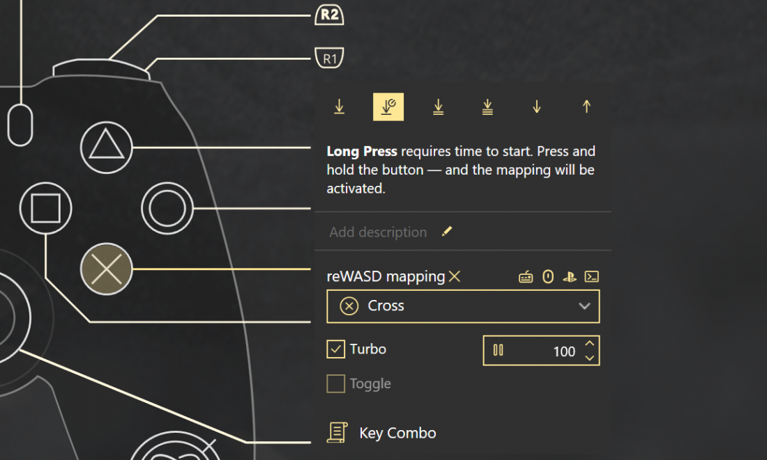

                  Now i ran into another problem with Bunny Hopping / Jumpshots (sprint, jump and then jump again as soon as the you hit the ground). There is a problem with a delay:
                  I want it to keep spamming the jump button (X) when i do a "Long Press" on X. So i set the turbo to 100ms: See the attachement...
                  The problem is that if I press X just a single time (not a long press), then there is a noticeable delay (it feels like more than 100ms).
                  I also played around with the Press Time of the long press but this doesn't seem to help :/
                  I feel like this has to do with reWASD processing/checking if the input is a normal or a long press, but 100ms+ seems to be a bit to long.
                  Is there any workaround or solution to this?
                    Default [Long press] value is 300ms. You can set it as low as 100ms in [Preferences > Press time]. If 100ms is still too much you can check [Start press] or [Release press] activators. They aren't affected by activator timers.
                    [Start press] activator will fire up once when you press the button. [Release press] activator will fire up when you release the button.
                    To avoid multiple triggers, you might want to set [Single press] activator to [None] and set an [Unmap] flag on it, though that will disable the ability to hold that button in game.

                      I have managed to set it the way i wanted:
                      1. Set [X] to unmapped (first tab)
                      2. Set a 100mms Turbo on a long press (second tab)
                      3. Set "Start Press" to Button [X] (second last tab)
                      Now when i press [X] just a single time, then the jump in the game gets registered immediately and there is no delay. When i press [X] a bit longer (like 300ms) then the jumping repeats itself in a loop.
