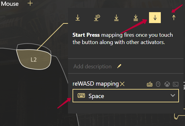

    2. In reWASD, go to paddle and set Start and Release activators (both ones) to the same key binding that is used to toggle the ball-cam in the game (Space in my example)
    3. Create a Shortcut of two, three or four buttons that will be used to activate ball-cam for the first time. You can learn more about shortcuts in our help guide. Map it to the same key (Space).
    That's it! And this is how it will work: at the beginning of the game you need to press shortcut from step 3 to activate ball-cam. In order to switch it off, you need to press and hold the paddle. Once the paddle is pressed, the game will get the second "Space" and will turn the toggled mode off. When you release the paddle, the game will get one more "Space" and will activate this mode again.
