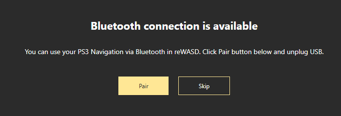

    DualShock 3 and PlayStation 3 Move Navigation controllers
    Essentially, DualShock 3 and PlayStation 3 Navigation controllers are intended to use wired on PC, and it's usually problematic to use them wirelessly. We support DS3 and PS3 Nav wired, or if you use a Bluetooth adapter the controller will be recognized by reWASD too. These connection methods were tested and are approved by our team.
    When you connect the Navigation controller to PC via cable, and have a Bluetooth adapter, reWASD will ask you to pair it before you start remapping. You will see this message:

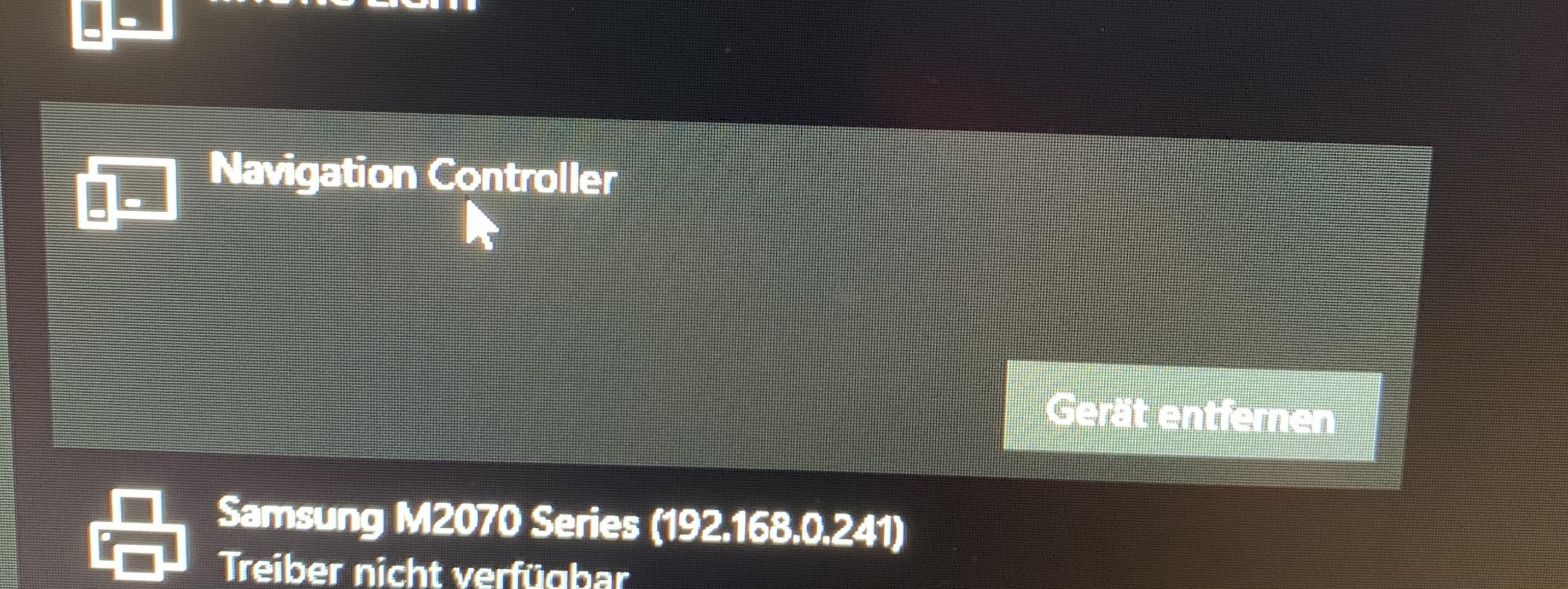

        I have completely uninstalled scp toolkit and have not installed any other programs. the sony navigation controller is connected with a cable. I also tried a 2 Sony navigation Kontorller and another cable. it is recognized in windows 10 but in rewasd there is no response to the device nor an xbox controller. only the plugged in mouse and the keyboard are recognized.
          1. Do you have an original PS Nav controller or sort of clone branded other manufactures?
          2. Please, make sure that nor mentioned utilities or drivers (hidguardian, vigem) are not installed.
          3. How does the Windows 10 recognize the controller? Please, open the joy.cpl and take the screenshot of the displayed controller.

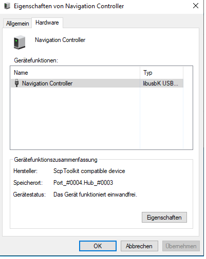

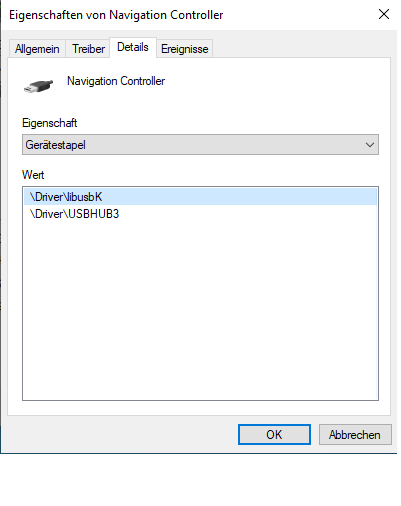

          4. May I ask you to check the driver's stack of the device? Open Control Panel\All Control Panel Items\Devices and Printers then select your controller device - > Properties - > Hardware - > Properties - Details - > pop down menu - Device stack. Take a screenshot.

              1. yes i have 2 original sony navigation controllers
              2. I checked everything. there are no more programs installed
              3. with other devices the controller pops up in windows 10 as soon as I connect it to the pc with the usb cable
              4. other screenshots follows
              5. I thank you very much for your effort and help

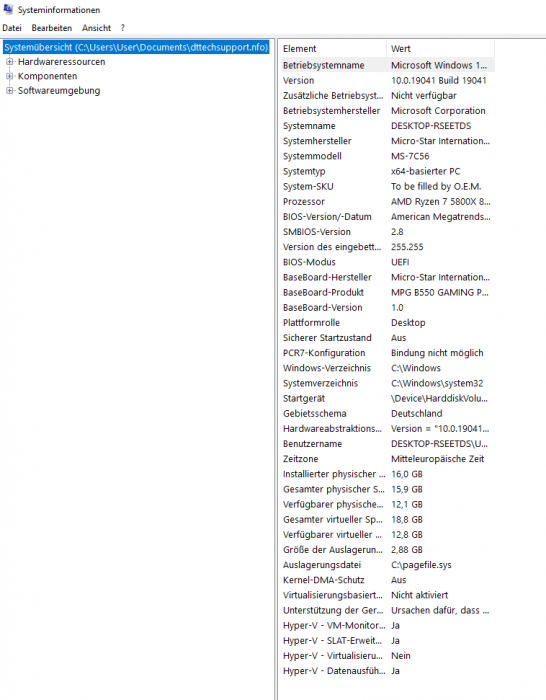

                Then, I am waiting your screenshot of the driver's stack and also, please send me the msinfo file - http://recordit.co/hRk85POAat

                    Sorry, can't see the information, screenshot is too illegible. Please, take it bigger, please, and don't forget the msinfo file.
