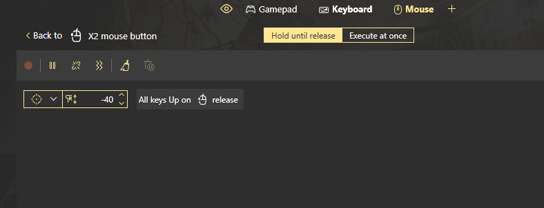

    Hey guys, im trying to do a simple 'macro' to the Right Stick kinda compensate for recoil, like if im pushing right stick down, but my script simply doesnt work and ive tried a lot of other ways i find here on forum. If i simply press the shortcut button yes, the script will work and my right stick will go down, but if i press ANY other button like shooting, crouching or anything, the script kinda pauses, so it seems that is one action or another.

    You have [Absolute deflection] node there. For recoil compensation you need to use [Relative deflection] (click on the left side of the node to change it):

      thx man, i will try the recoil with this setting in a min, and my config is here

          well thx, i get the recoil and working on it, its better
