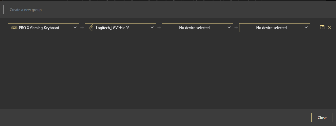

    I just got rewasd and everything works fine. Only my mouse doesnt get showed as a controller. But my keyboard does for some reason. And yes I checked that I use the correct mouse. I hope anyone can help me out there. Even tested several configs without success
    Please show me your group, like here:

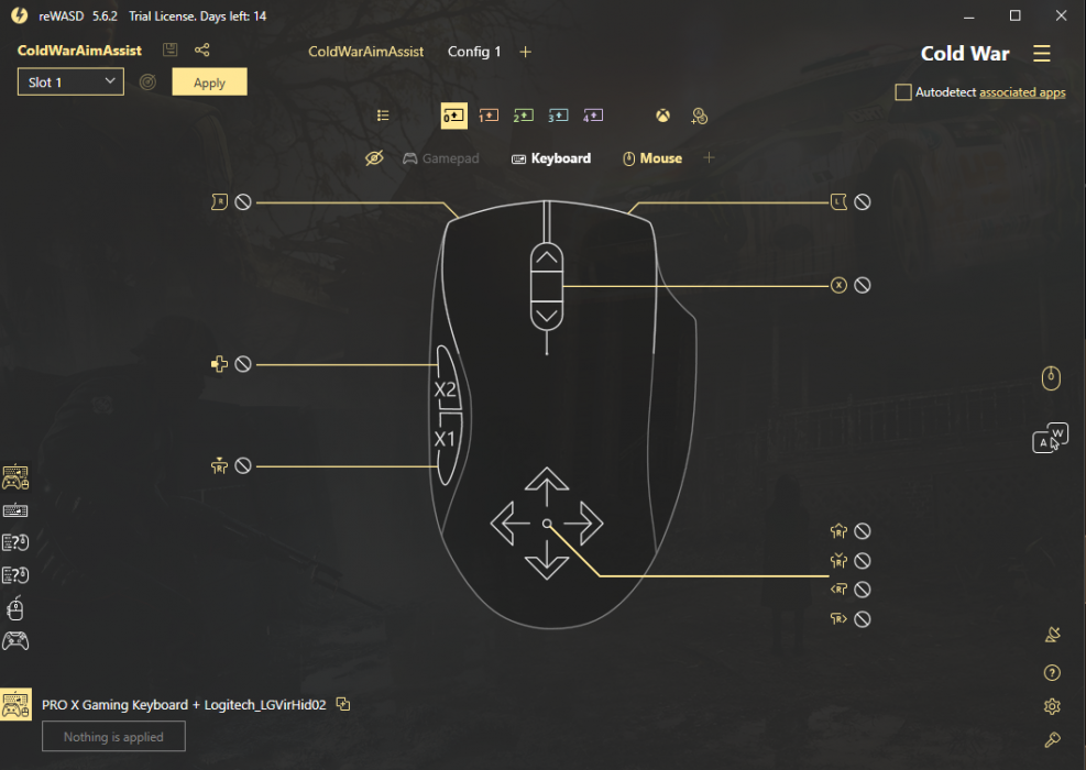

    Also attach a screenshot of the mouse settings in reWASD.. Thanks!
      These are both of my settings

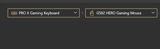

        The mouse in your device group is not the physical mouse to which you apply the config. Ungroup devices, enable Device Detection mode to detect your physical mouse then re-group the devices and apply the config to this group. Here is a help article on identifying devices.
          I was running "Detect active devices" and saw my correct mouse name. After I setup the correct mouse and ran the program nothing worked other then the mouse wheel​​​
