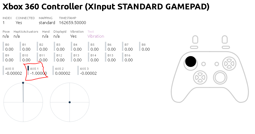

      The Left Stick registers -0.98, -0.99, -1.00 near the end of the travel upwards. I do not think it's the gamepad.
        What I meant was to check at what actual physical point does that stick go to 1.0.
        Though I'm afraid I can't suggest much here anyway. reWASD works with the data that is being sent by the gamepad. If it sends values over 32766 at about 80% deflection, then that's most likely what's happening.
