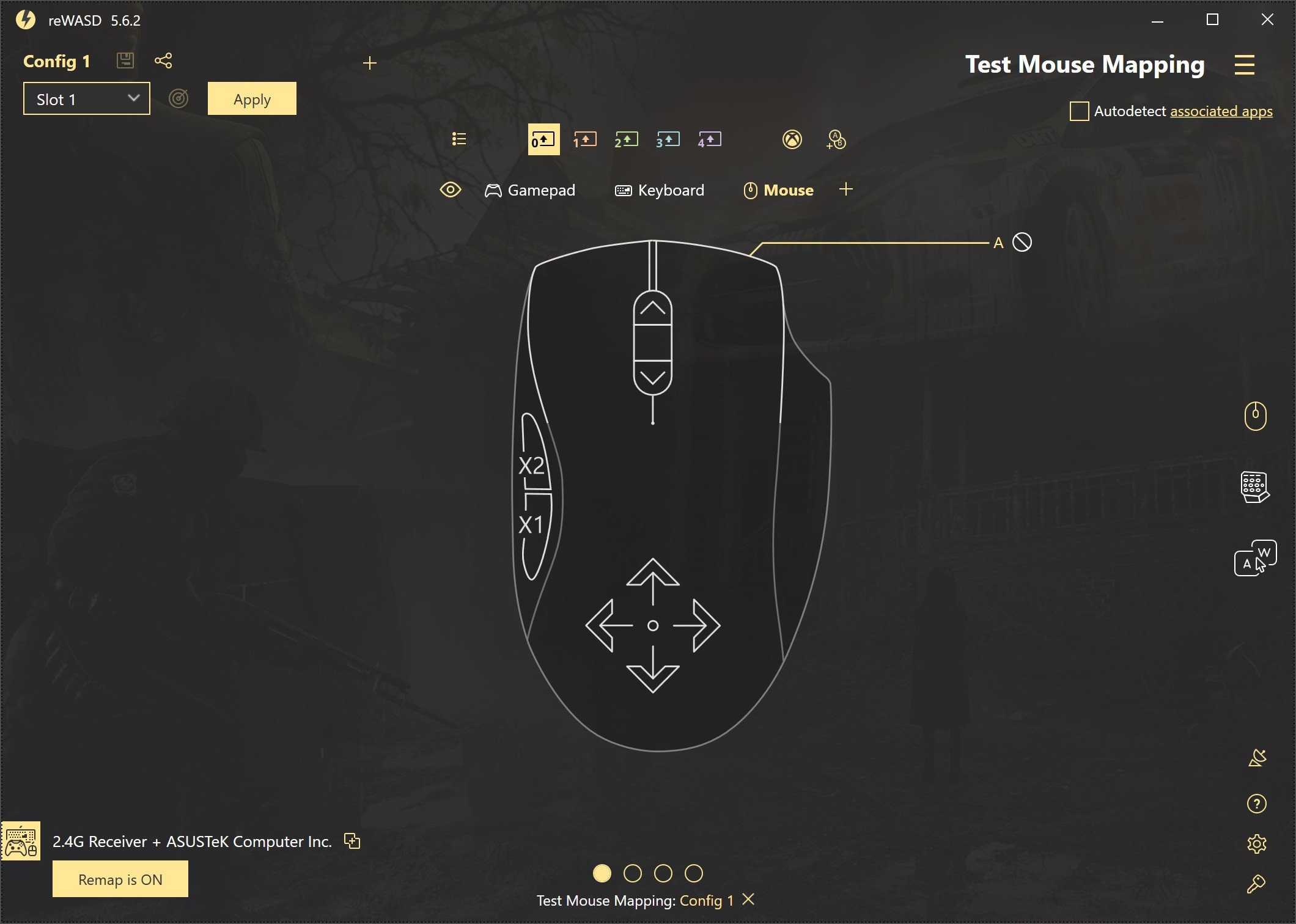

    Here's a screenshot of the simple config:

    reWASD support wireless devices, no worries. The only thing is about the initializing. In most cases, both devices are recognized in reWASD as a single one, and it should be initialized as a mouse. Then, you can add Keyboard mappings to the Additional mouse buttons section (you can see this icon at the right, in the center of the window).
    I assume that there is something wrong with the device initialization at the moment.
    Please follow these steps:
    2. Use Detection mode to find the correct Mouse. If you press the mouse button but see keyboard in reWASD, then you will need to re-initialize it (from the context menu of an active device)

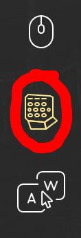

      Thank you for the quick response. It worked!
      So any wireless kb/mouse combo needs to be initialized as a mouse.
      Then keyboard remapping can be done via "Additional mouse buttons" and no longer through the mid/top Keyboard option as I've tested.
