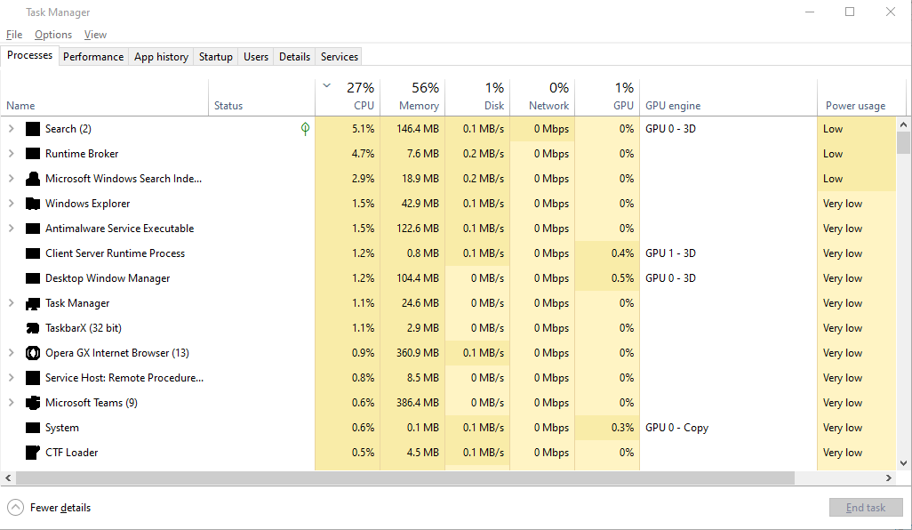

    I downloaded it to try out valorant on controller, found that it currently doesn't work as valorant had some changes, so I just uninstalled it. When I went to launch valorant again after uninstalling (and rebooting) my mouse was locked in place in the top left, and had to restart my pc to get my mouse to work again. I redownloaded it, launched valorant while it was open, and it was fine, mouse working. Icons still turn black for some reason but it isn't a huge deal. Is there a way to fix this so I don't have to have rewasd open at all times to play valorant? I dont even have the controller anymore so I need it on my pc.

    And please attach a screenshot with the black icons that you wrote about.

      yes, i tried play controller by emulating a mouse. I think i added the right .rewasd config. I have reset the config many times though. I also added the black icons that show up in task manager, a few programs will show like that in the taskbar aswell.
        Try not to move your mouse when starting Valorant if you use it with reWASD and controller. If not and you do not it, then remove reWASD for now, restart your PC and check if our Virtual Input Device is in the Control Panel\All Control Panel Items\Devices and Printers path and delete it.
        The icon problem is unlikely to be caused by reWASD. I recommend trying to update/repair .NET. Also, if you have the restore point, try to get back to it.

                      Though I see you have black icons and probably two GPUs there. Is it a laptop? Windows 10? You might want to reset/update your video drivers. Black icons thing is not normal.
                        Hello rolphcaleb !
                        According to this and other threads on Reddit, black icons appear if Valorant is installed on the newest Windows version (2H21). This issue is not related to reWASD, and the game's developers are aware about it. I think you should contact their support team if you want it to be fixed faster or consider downgrading your system.
