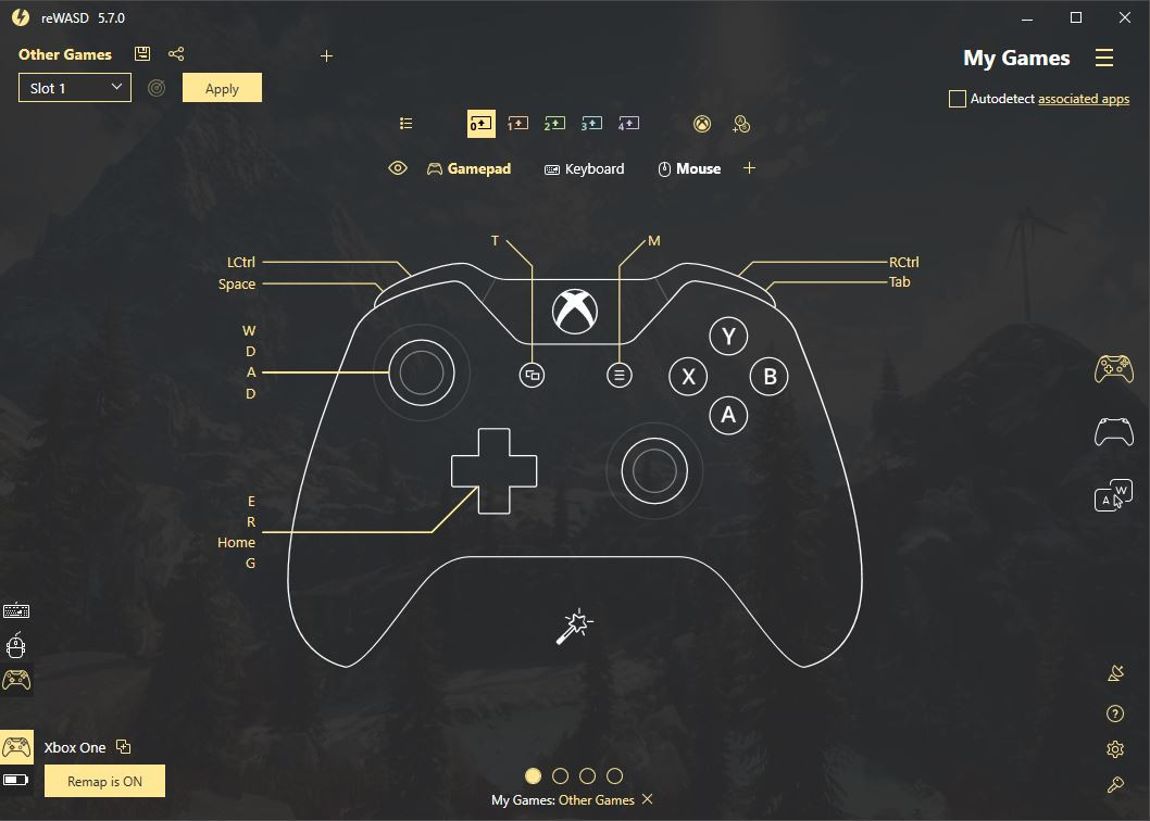

                      Update: I used the autodetect associated apps feature which I wasn't using before. I associated the games EXE and the game used the ReWASD mapping. Not sure why this is required now all the sudden. When ReWASD is open on my desktop, when I activate the controller, it still doesn't show the button pushes in ReWASD which it also did before.
                        [Autodetect] is a feature to auto-apply selected config to a selected slot when associated app is in focus. There is no need to enable it if you're applying config manually.
                        [Hook controller buttons] must be enabled at [Preferences > General] for that.
                        Can you upload a screenshot of reWASD window in full once you've "activated the controller"?
                          OK, You are correct, I unchecked autodetect associated apps and it still worked in game.
                          I checked Hook Controller and it responds to input now. It seems to be working as normal now. Either the Windows update or the ReWASD update caused it not to work but now it is. I messed with so much, not sure what fixed it but thanks for your help. It is working great again.
