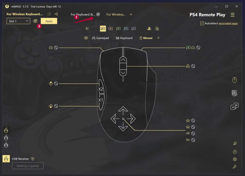

                      Auto detect detects both mouse and keyboard as the same. It worked at first but when i off-ed remap and reactivated it didnt
                        It seems that you have enabled Autodetect for the previous config, the one that is suitable for the "normal" keyboard and mouse (1). Please switch to it and remove the Autodetect mark here (2). Then open the config for the wireless devices and enable Autodetect for it (or just Apply manually):
