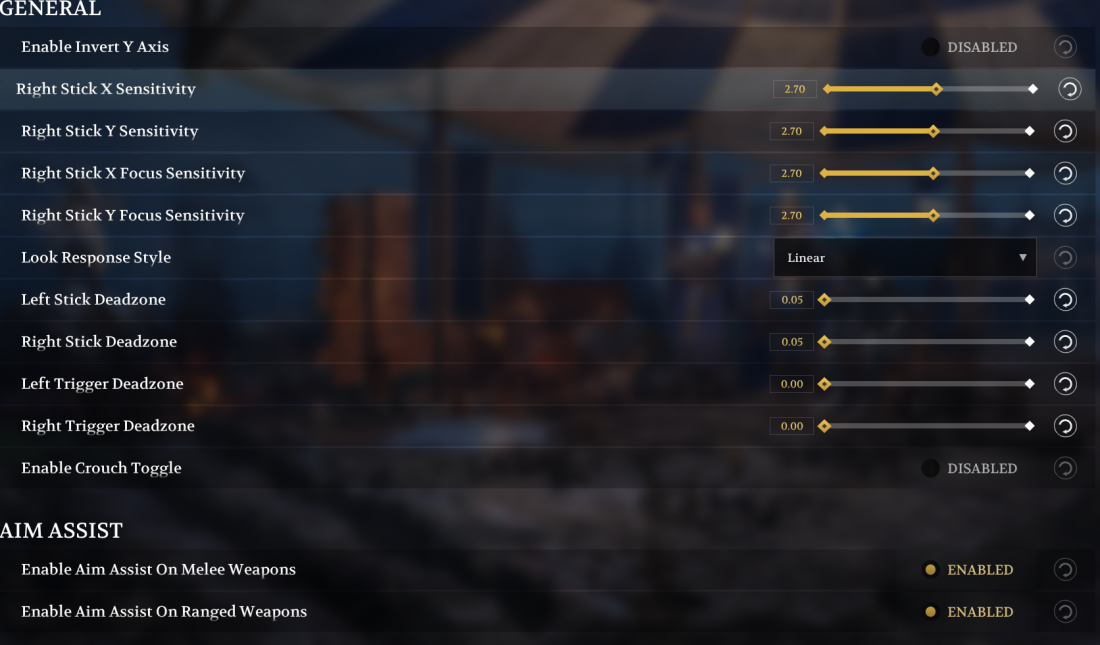

    So i'm using a previous config from Apex legends for aim assist in chiv 2, I changed the mappings but not the mouse curve. I did change deflection from low:100 med: 20063 to low:100 med:32768 and lowered the inital speed to 8 from max. This was fixed my aim from flying all over the place but it still doesn't feel right it feels too slow. I'm going to try putting the sensitivity in game to max and try to get the right rewasd from there.
    That's the way. In-game sensitivity setting will set the maximum possible camera turning speed, while [X/Y Sensitivity] along with [Response] curve in [Advanced setting] of reWASD will set "how fast you can get to that maximum speed".
