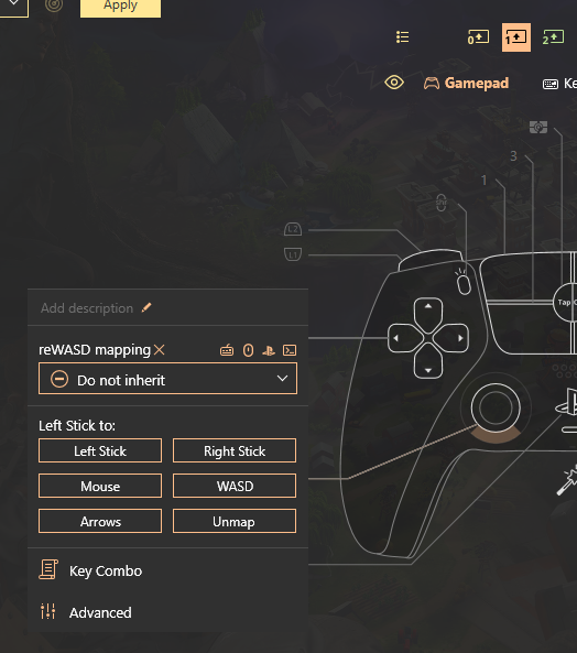

    Try setting the buttons responsible for movement in your layer to "Do not inherit".
          I tried that, but as I suspected - I no longer had movement to my analog stick lol. I'm using only keyboard scripted keys for all of my buttons btw.
