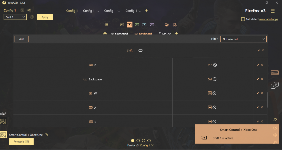

    Just updated to 5.7.1 and shift layer1 no longer works with the keyboard.
    How to fix?

    Please specify does the keyboard working the basic configuration? Did I understand correctly that you have a group of devices with a keyboard and a controller?
      This is group of devices (xbox one controller, keypad) The keypad worked fine in shift0 and shift1 before update. Now it doesn't work in either.

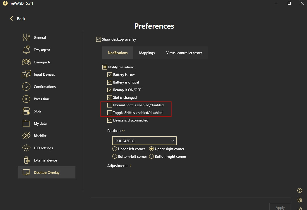

          How do we disable the pop up in the lower right that announces every shift change?
          You can disable overlay notifications in the settings. To do this, go to Preferences -> Desktop Overlay -> Notifications.
          In your case you need to disable notifications shown on the screenshot.
          Or you can disable notifications completely.
