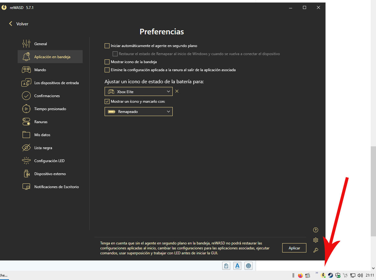

          I´ve updated reWASD to the last version 5.7.1 and now I don´t need enable gamepad for the game in bigpictures from steam but the problem I have now it´s the icon tray stay in the tool bar after I close reWASD and the game
          I´ve tried in options all disabled but the icon tray appears when I launch the game and it doesn´t dissappear:

            For disable the icon tray I need click in "Show icon tray" + apply and then uncheck "Show icon tray" + apply everytime I launch a game using reWASD
              Tray icon should be visible only when an option to show it or a battery status of your gamepad is enabled. In your case latter seems to be enabled.
              reWASD is unable to launch any games. Maybe you've meant the [Autodetect] feature?
              I was unable to reproduce this. Would be great if you could add more information about the issue. Now I can only suggest to use [Clear data] button at [Preferences > General] or to do a clean re-install of reWASD.

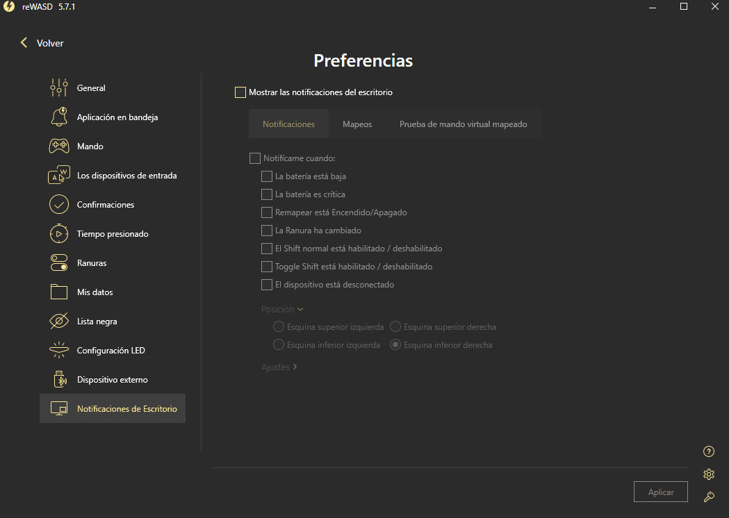

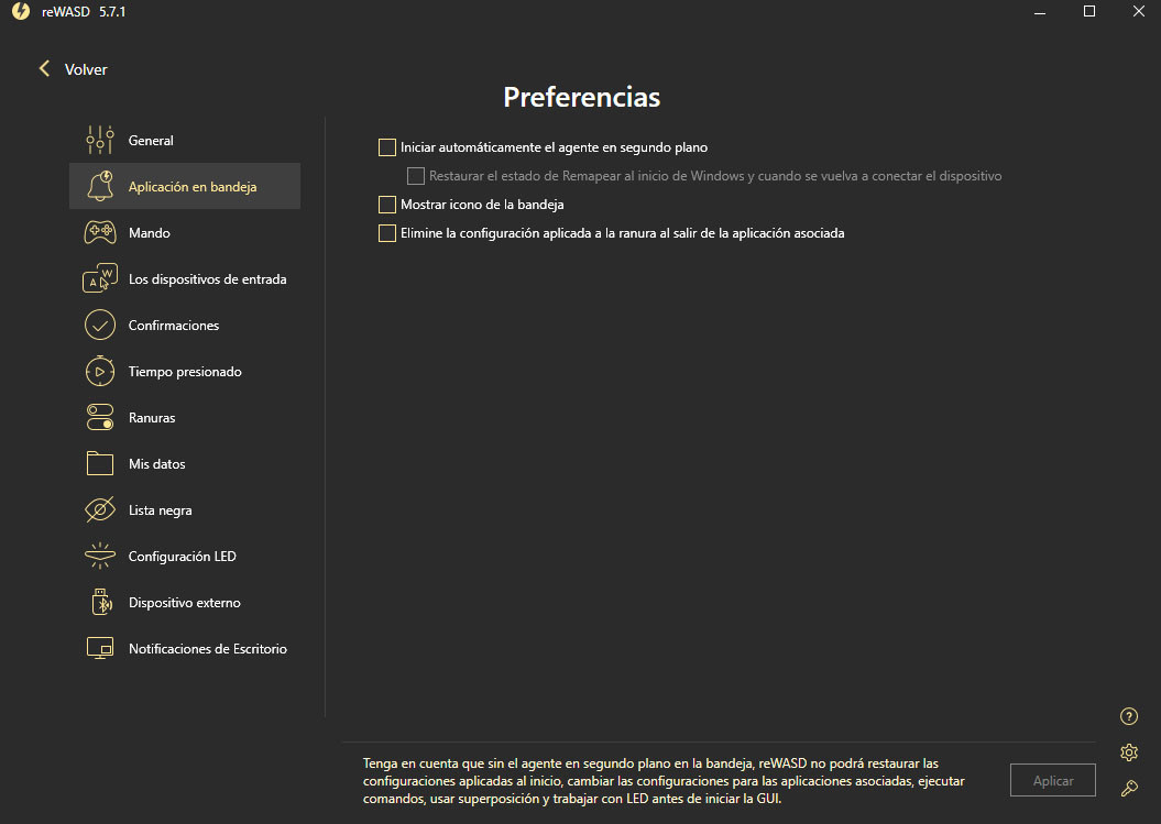

                - I uninstalled reWASD, deleted all my profiles (I did a backup)
                - I reboot my pc and the I did a clean install with the last version 5.7.1
                - I left everything unchecked in preferences and in desktop notifications:
                - I reboot my pc
                - I open rewasd, I launch any game from steam and then the tray icon appears in the right down corner like in image I attached
                After that the only options I have for disable the tray ico is:
                1º Rebooting my pc or
                2º Go to preferences check tray icon and apply + uncheck tray icon and apply
                In fact if I click with right button mouse to the icon, appears the option "Hide" , I click there but nothing happens.
