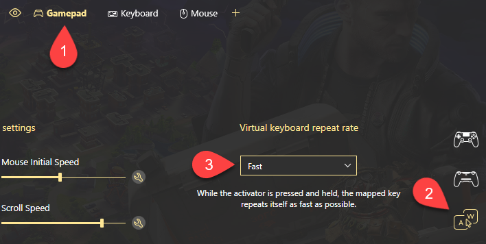

    You can try changing [Virtual Keyboard repeat rate] here:

    I'd suggest starting with [Do not repeat] option first, then the [Slow] one.
      Thanks, that seems to have fixed it! Why was it on fast to begin with? That seems.... likely to fail?
      I was just running with "Do not repeat" and seemed good. Is there some reason slow or faster is actually preferrable?

        [Fast] is usually the default. But different games may react differently, so there is no universal best option.
