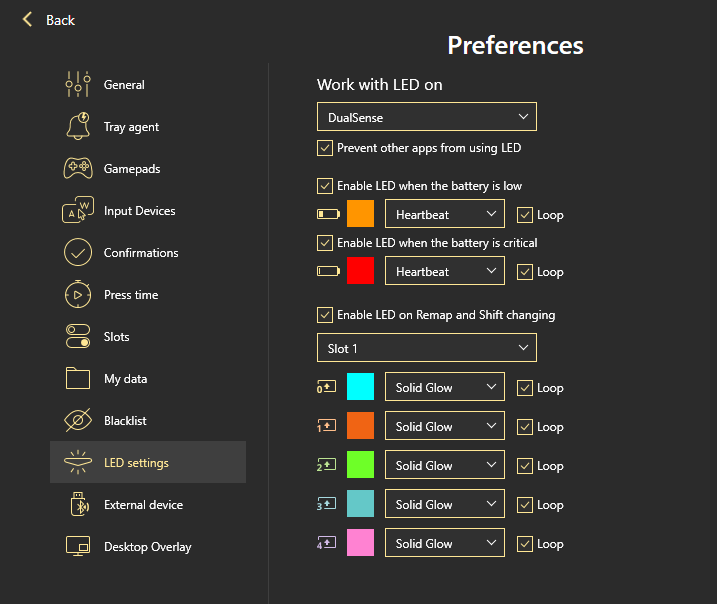

    This is how it looks like in the 'default' settings:
    I've only changed the default 'Shift 0 Modifier' to a blue hue, and it works in everyconfig file I have.

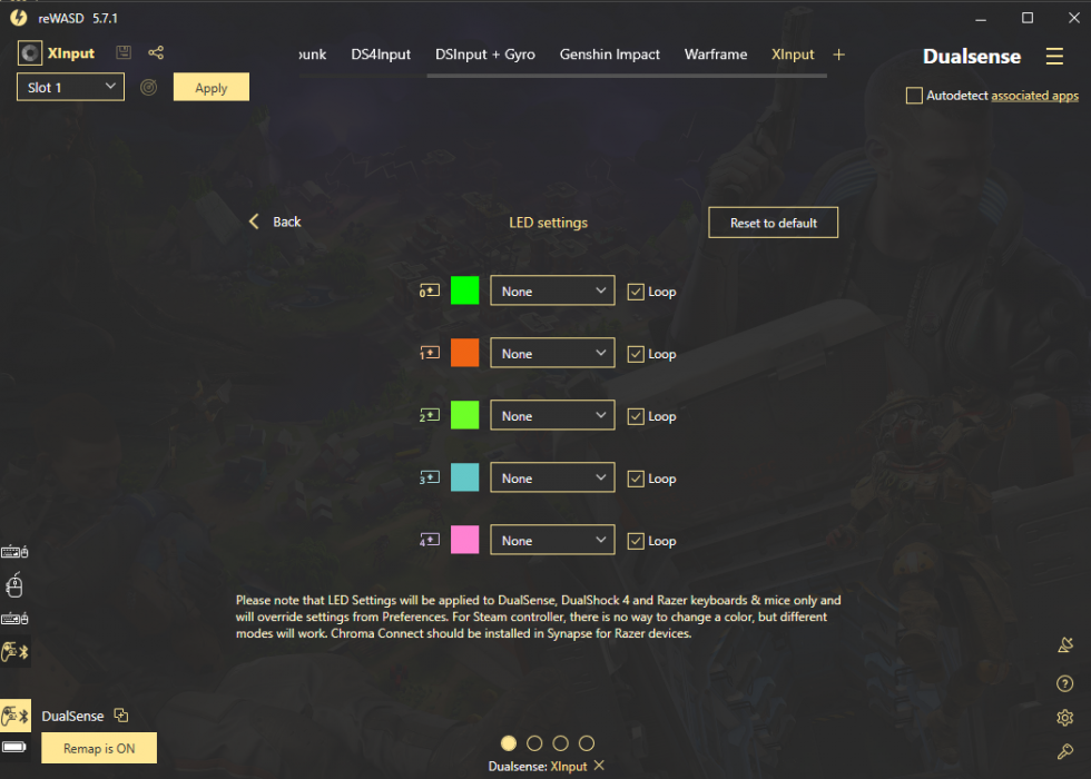

    Then, I try changing it to a green hue when using it to emulate XInput devices (Xbox controllers, basically) and this is how it looks like:
    Just to clarify the obvious here, I did try saving, applying, saving and applying, switching configs, reconnecting the device and even switching devices. Nothing worked. When I open the same screen, the LED setting ARE SAVED, I do not need to put the green hue in there again. It's just not working/applying.

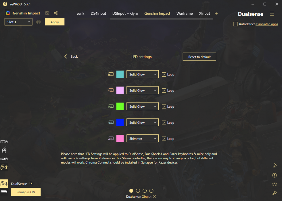

    With that said, I do have ONE config file forthe Dualsense that does work, and there's only one key difference that I can't seem to find a way to "implement" it to other configurations.
    This is the config file for my Genshin Impact controller layout, I use it to be able to use the "interact action" on the touchpad click and allow gyroscope aiming, simple stuff.
    The major difference in this config file is that ,as far as I can remeber, this specific config file was the wone created when I added the "Dualsense" profile, in the upper right corner drop down menu. And since it was created, the LED settings button is actually colored, while any other configuration I make inside this profile gets a monochromatic grayscale icon. This also stands true to any other profile I create, for any device. The first config file has a colored icon, while any other gets a gray icon.

    There are two things that should be set inside the config for LED: the color and the mode.
    In your XInput config, there are needed colors, but you haven't set the mode (it is None as far as I can see on the screenshot). Please set it to Solid Glow (if you want LED to have a simple light) or any other mode you like (the LED will be blinking, glowing and so on). Then, it should work as expected.
      Man, I can't stop laughing at my own stupidity. It was literally in my face. I feel like a total idiot. How could I not notice it even after taking the screen shots, and worse, this whole time tweaking within it? Anyway...
      Thanks a lot!
      That was the problem, aparently I can't see lol
        No problem, that's why we are here. reWASD has lots of various options, settings and mappings, it is totally OK if you have missed something. No worries
