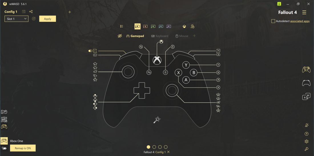

    I am using Windows 10. My PowerA Fusion Pro 2 controller is only detected by reWASD when I choose a controller-only configuration. I can remap the controller in this mode. When I switch to controller + mouse configuration, the controller is no longer detected by reWASD, though it continues to work as a non-remapped controller on Windows.
    Hi. Please send screenshots of the full reWASD window with your configurations that you apply to the device group.

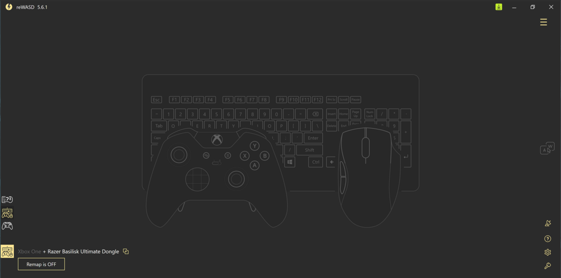

      For the Xbox + Mouse config, it will not let me turn remap on and it does not detect the controller.
        Icons at the bottom left are devices and groups of devices, not the configurations. It seems at some point you had two Xbox One controllers (or something that poses as one) connected to PC and reWASD saw that. The controller in the group on second screenshot is currently not connected to PC and is not the same device selected at the first screenshot. You should disband the group on second screenshot and add an Xbox One controller from the first to it. You can read more about groups here.
