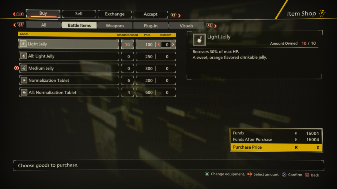

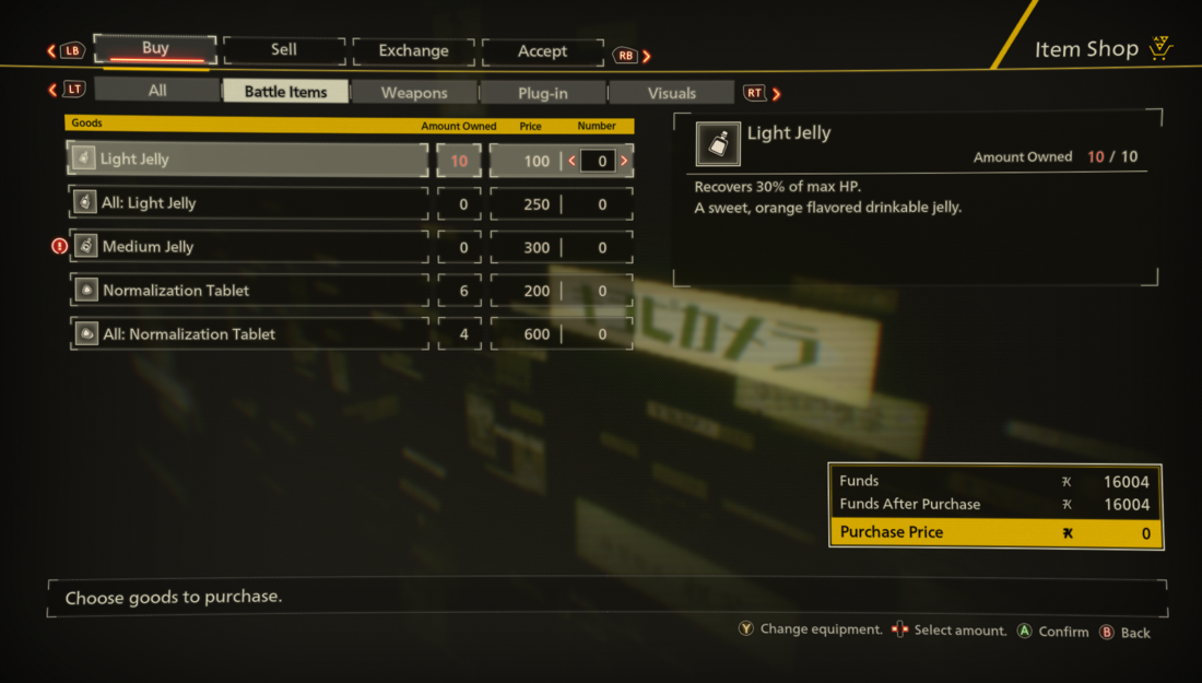

    I am having an issue with Rewasd while using a profile that I set to Xbox One Virtual Device (Since my controller is an Xbox One Controller). It works just fine but when I use the Triggers in the game, prompts appear as DS4. I tried to resolve the issue, and it seems only to be fixed if I connect a different controller first then using my main controller, then everything works just fine, but that is honestly not a solution for me.
    Would someone be able to help me with this? I attached screenshots in-game and my configuration. I have the option to hide the Physical controller when using the virtual one.

          I checked the gamepad tester and some other games, but it looks like the issue is with Scarlet Nexus only; I turned off all support for controllers in Steam. I reinstalled Rewased itself, but I also found something interesting when using my Gen 1 PS4 controller. I can't use my triggers altogether, which is absurd cause if I choose to remap it as an Xbox One Virtual device, it works.
          Did you guys have any issues with someone playing Scarlet Nexus cause? That would at least help me understand why that happens altogether. I can't understand why this is happening.
