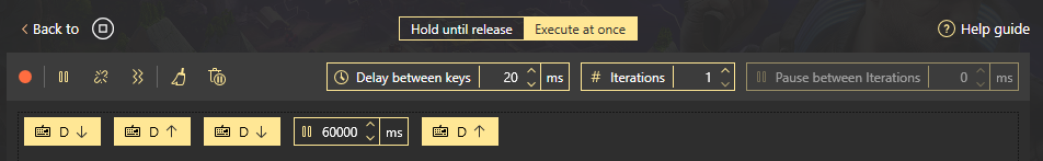

      If I want map a double press of a button lets say D on my keyboard to a button on my gamepad, but i want the second press (of the D) in the key combo to hold the button down. in the key combo menu it should look something like "D ↓ D ↑ , D ↓. I can only get it to do a regular double press of the button, with the last input being the button going up after the press. Is there a way to do that? Also, preferably, I want to hold the assigned button on my gamepad to simulate that D button being pressed down, and to keep the d button pressed down as long as I'm holding it. I know this may be confusing but I could elaborate more if you don't understand. Thank you for your help.
        Try a [Key Combo] like this with [Turbo] flag enabled:
        It will hold the last [D] for 60 seconds or until you release the button.
