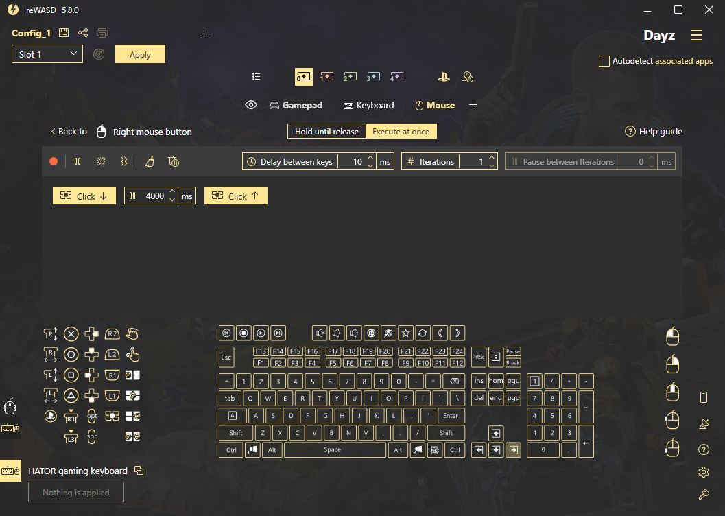

    This action can be completed using the Key combo feature.
    The only thing is, from what you described, I assume, you wish to press the touchpad, like it is a button, correct? The actual, physical press, not just tapping it and holding a finger on it?
    In that case, you can just add the touchpad press to the combo and add the pause between its press and release. Pause itself will determine how much time the button will be pressed. The value is in ms.
    On my screenshot, the pause between press and release is 4 seconds.
    Still, in some cases, the game might require a combination of Tap + Press to be completed. In that case, add tap press and release before and after the pause, like on the 2nd screenshot.
