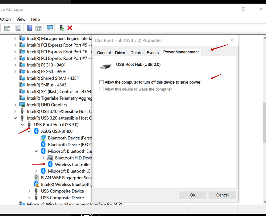

Unfortunately, it happens pretty often with some dongles and Nintendo controllers. Not only reWASD, but the system itself could not detect the controller after the restart. You may try to find your dongle in Device Manager and uncheck the following option:
Allow the computer to turn off this device to save power

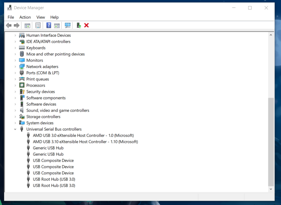

Here is an example (but ensure that you have found your device). Also check the dongle in Device Manager. If it has Power Management tab, then you should uncheck this option there too.
