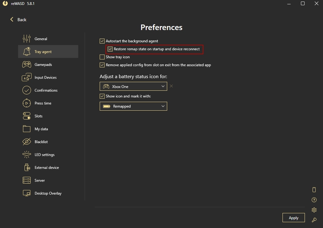

          Your case is now clearer. Thanks! The only setting that affects the return of the remap status after starting the PC or reconnecting the device is the "Restore remap state on startup and device reconnect" setting, which is located in the Tray Agent tab.
          You need to check this option.Click image for larger version
