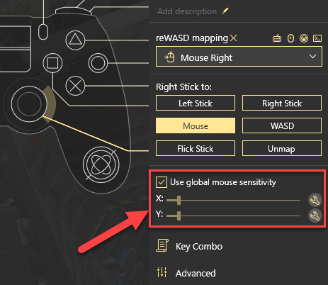

    So your goal is to remap controller to KB&M, because the game doesn't have prone command for controllers, yet stick feels different. First time I've seen a request to remap stick to a mouse while keeping the "stick feeling".
    I can only suggest trying different values for [Virtual Mouse sensitivity]:

    Changing mouse sensitivity, smoothing and acceleration settings in the game might be of help too if they are available.
      I will try that, I appreciate the help. This software is really intuitive and customizable and will come in handy for some of my other games
      For warzone though, I didn't want to move away from controller, I just really wanted that prone feature that KB&M players have. Losing aim assist is also a bummer going this route as well.
