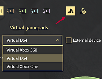

    Could you please try to change the virtual controller type in reWASD? I assume that Fortnite doesn't detect the virtual controller between the games, so this is why it happens.
    You can change the type here. Please check all three types and ensure that you have restarted the game after each one:

      I tested it but it didn't work :/
