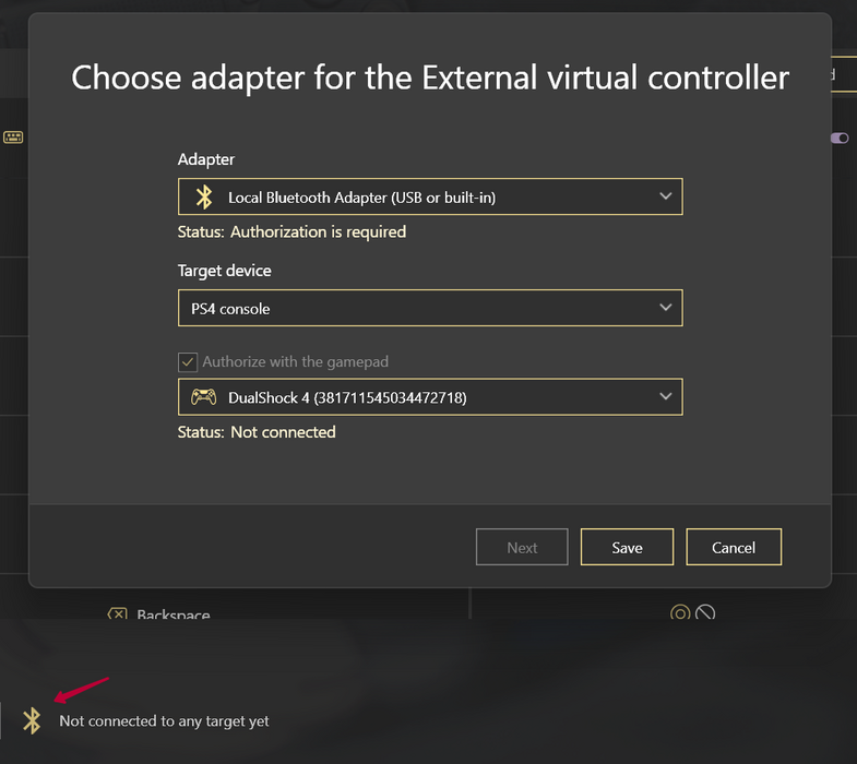

    Please click the Bluetooth icon to see the same window I have here after you adjusted the adapter and are trying to connect to the console:
    Do you see any hints in Status line under the adapter? Please show me the same screenshot.
      It works this way I already figured out, thanks, but I would rather ask if it is not possible to make it work without connecting DS through the usb? Do I neccessary need to use external controller ?? I mean, Im trying to set this up for a splitscreen play off two. So I want to use original DS and virtual one at once. Does it affect my virtual controller somehow? To have this other ds plugged in and logged onto another ps account at the same time?
        You need the physical DS4 to be connected to the PC so we could authorize the virtual controller for the console. Without this step, it won't be possible to play with a virtual controller.
        It can be connected via BT to console at the same time though, it should work too.
          I am sorry for the misinformation in me previous post. Unfortunately, it won't work this way. You need a separate DS4 controller for the authorization, and it should be always connected to the PC. It won't work on the console at the same time — in 8 minutes console will need the authorization, and it will be disconnected. In order to use keyboard and controller, you will have to purchase one more physical gamepad.
