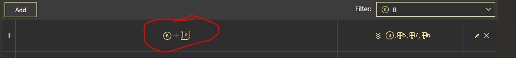

    The person who responded seems to understand exactly what they need and how to do it. My problem is i tried to do it, and when i make the RT+B command, it doesnt have the "cross" command part, so to make it work, its asking me to press them exactly as the same time. I want to be able to pull the right trigger down, then press B and have it activate, not press them exactly at the same time. How do i add the cross command? Ill show examples with the snips im talking about.
    The first picture is what i WANT. The second picture is what is happening when i try to make it myself...making the issue. I hope this post is coherent.

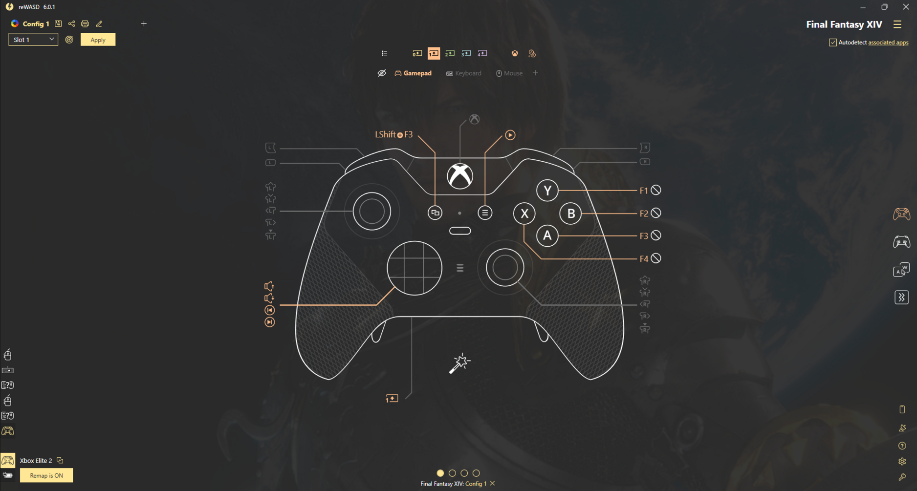

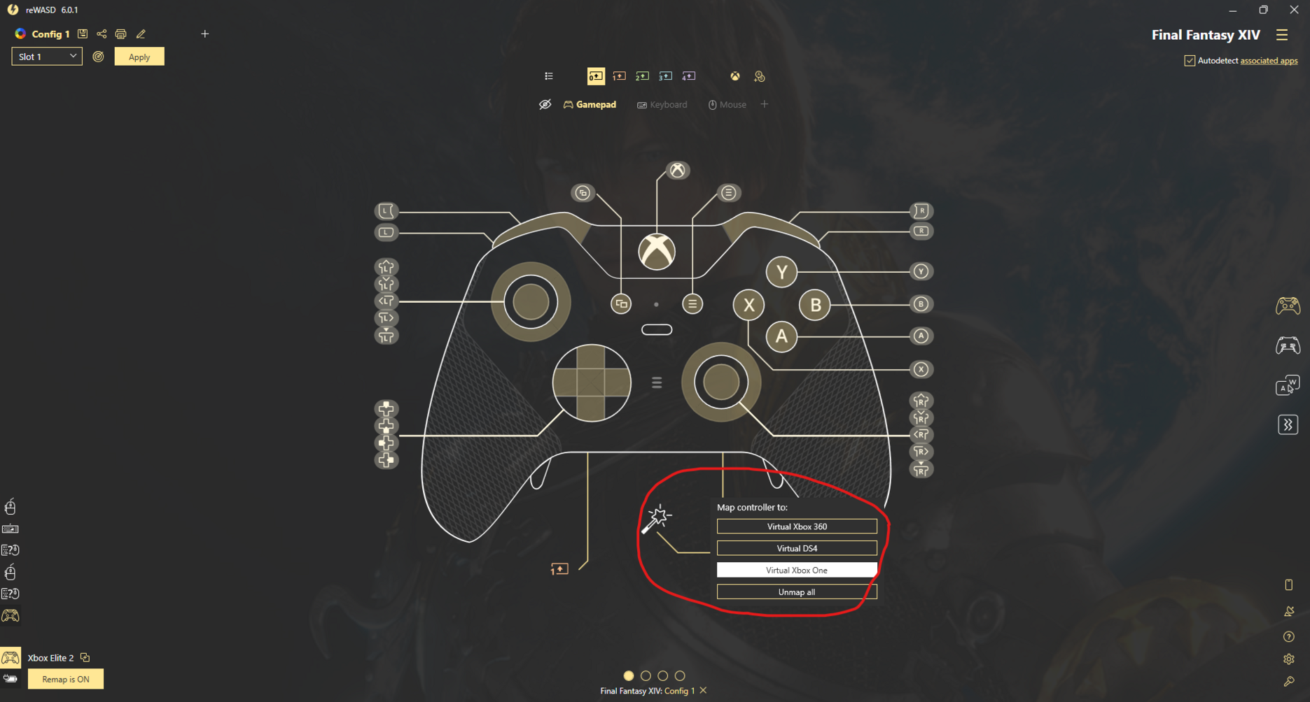

              EDIT, putting this in a new post because I'm not authorized to update my last post: Wow, after battling with this for days, I figured it out myself a few minutes after asking for help, I'll leave this post in-case anyone else runs into the same issue. Here's the fix: Don't use the magic wand to 'Map controller to:' setting. Mine was mapped to 'Virtual Xbox One'. I must've accidentally turned it on when I was playing around and discovering the features. Then, just go to your shift layer, set your macro key AND set the gamepad mapping to unmapped. Do this for all your buttons and you're set. Couple of images to demonstrate, turn off the thing circled in red, then un-map the gamepad mapping on your shift layers.

                The virtual controller should be used only if the game does not support the original one or if you need to use a combo, turbo or other features.
                In other cases, you can do without a virtual controller, this will avoid such nuances and speed up the processing of commands by the game.
