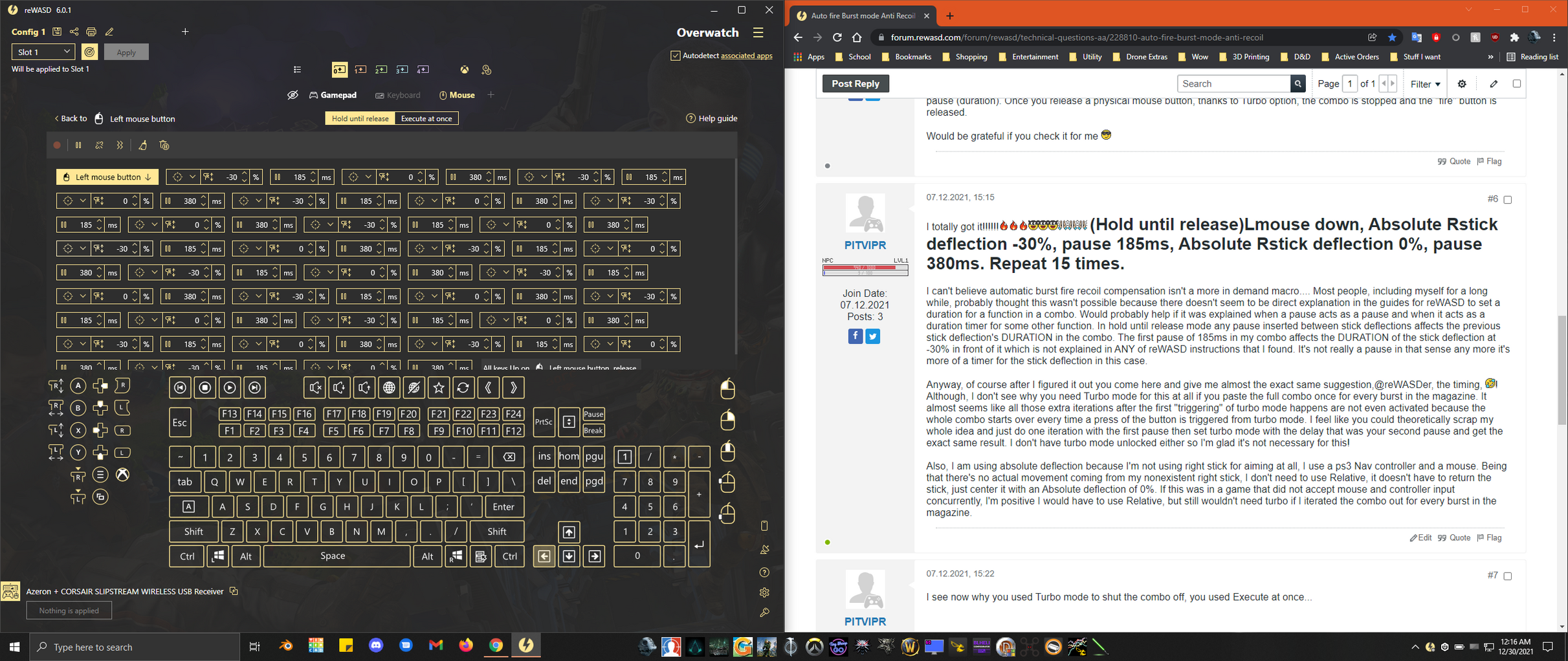

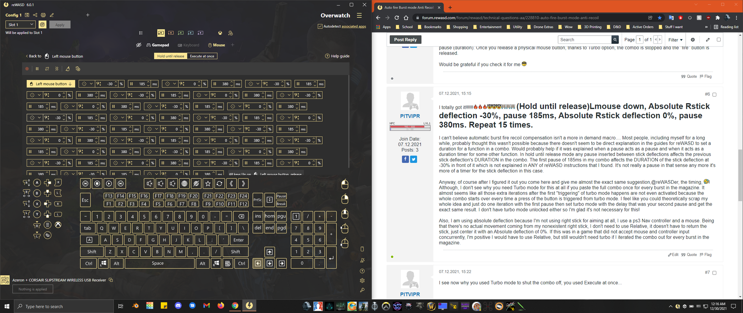

            I totally got it!!!!!! (Hold until release)Lmouse down, Absolute Rstick deflection -30%, pause 185ms, Absolute Rstick deflection 0%, pause 380ms. Repeat 15 times.
            I can't believe automatic burst fire recoil compensation isn't a more in demand macro.... Most people, including myself for a long while, probably thought this wasn't possible because there doesn't seem to be direct explanation in the guides for reWASD to set a duration for a function in a combo. Would probably help if it was explained when a pause acts as a pause and when it acts as a duration timer for some other function. In hold until release mode any pause inserted between stick deflections affects the previous stick deflection's DURATION in the combo. The first pause of 185ms in my combo affects the DURATION of the stick deflection at -30% in front of it which is not explained in ANY of reWASD instructions that I found. It's not really a pause in that sense any more it's more of a timer for the stick deflection in this case.
            Anyway, of course after I figured it out you come here and give me almost the exact same suggestion,@reWASDer, the timing, ! Although, I don't see why you need Turbo mode for this at all if you paste the full combo once for every burst in the magazine. It almost seems like all those extra iterations after the first "triggering" of turbo mode happens are not even activated because the whole combo starts over every time a press of the button is triggered from turbo mode. I feel like you could theoretically scrap my whole idea and just do one iteration with the first pause then set turbo mode with the delay that was your second pause and get the exact same result. I don't have turbo mode unlocked either so I'm glad it's not necessary for this!
            Also, I am using absolute deflection because I'm not using right stick for aiming at all, I use a ps3 Nav controller and a mouse. Being that there's no actual movement coming from my nonexistent right stick, I don't need to use Relative, it doesn't have to return the stick, just center it with an Absolute deflection of 0%. If this was in a game that did not accept mouse and controller input concurrently, I'm positive I would have to use Relative, but still wouldn't need turbo if I iterated the combo out for every burst in the magazine.

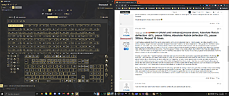

                    Here you go!!!
Name:	Burst fire recoil control.png
