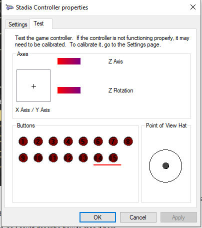

    The Stadia has two extra buttons over a 360 pad (14 and 15 in Joy.cpl). Unfortunately the standard Windows Stadia driver doesn't enable analogue triggers. I've installed reWASD which enables the analogue triggers but it then emulates the 360 so I lose the two extra buttons. Is there a solution to this? Can't we create a "generic virtual device" that has all the buttons of the host device, rather than just 360 or DS4?
    (I know I can map those two extra buttons to keyboard keys but I'd rather have them as joypad buttons)

      Hey. Thanks for the reply. Essentially I would like to use the Stadia controller with all 14 buttons detected by Windows AND with analogue triggers working. (Analogue triggers don't work unless I use reWASD and run a virtual controller of either the 360 or DS4). I would be nice if you had the option for a "Generic Virtual Pad" that had maybe 20 buttons (1 to 20) instead of 360 or DS4 buttons. They would then allow you to map the extra buttons that exist on something like the Stadia to this virtual pad and activate all its buttons?
