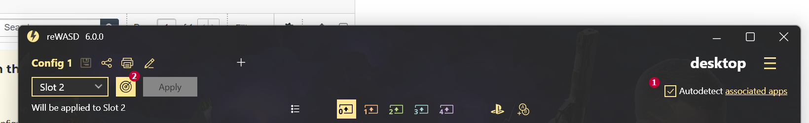

today i updated to Version 6.0.0. Everytime i play a "associated" game, my Desktop Configuration must be assigned again to a slot. Sorry for my poor englisch description I'm german. i try it with an example. I use the Xbox Elite 2 Controller, which had for Slots. All associated App-Profiles are mapped to Slot 1, Slot 2 is my Desktop-Config, Slot 4 ist my Native-Controller Config (if i play a game and don't want to make the association). In Version 5 it works fine. Start a "associated" game, close it, and Config in Slot 2 (Desktop) is acitve. But in Version 6, i close the "associated" game and the Slots of my Controller are emtpy. So i have to reassigend the Profile to the slots again.
If i uncheck the Option "Remove applied config from slot on exit from the associated app" the Slots are not empty, but also not active. But if i switch the Slots via Controller it still works again.
With checked Option "Remove applied config from slot on exit from the associated app", the Slots are empty.
