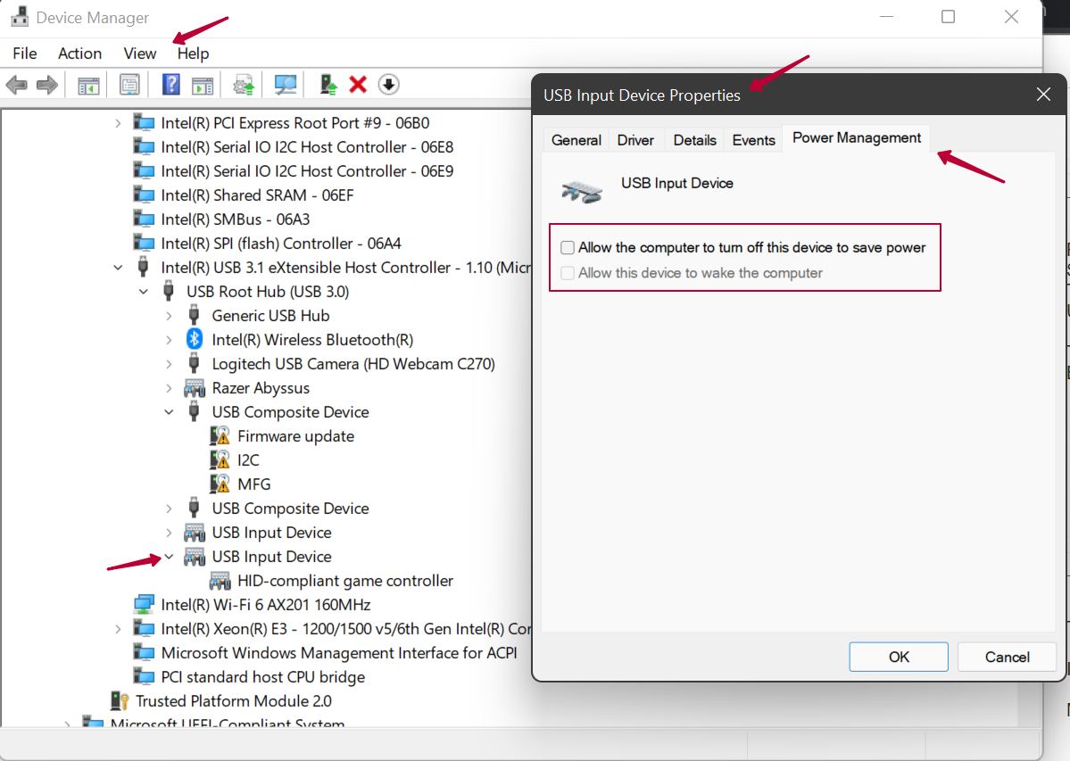

          I have one more suggestion for you though:
          1. In Device Manager, choose View by connection view
          2. Find your controller and navigate to USB Input Device
          3. Check if it has Power Management tab in Properties
          4. Uncheck Allow the computer to turn off this device to save power

            Doesn't seem to be there. I tried adjusting that mystery "USB Input Device", but that didn't work. The only "HID-Compliant Game Controller" I could find did not have a power management tab.
            I even went as far as adjusting the BIOS settings such that USB ports provide power even when the system is shut down. This did not work, either.
            In all cases, reWASD identifies that the controller is indeed connected. Whether or not the buttons work without requiring to disconnect and reconnect seems to fall on how Windows boots (sleep, fast boot, full boot, restart, etc).
              Hm, strange. You could try to disconnect the controller — the tab will be refreshed — and connect it again to see the difference.

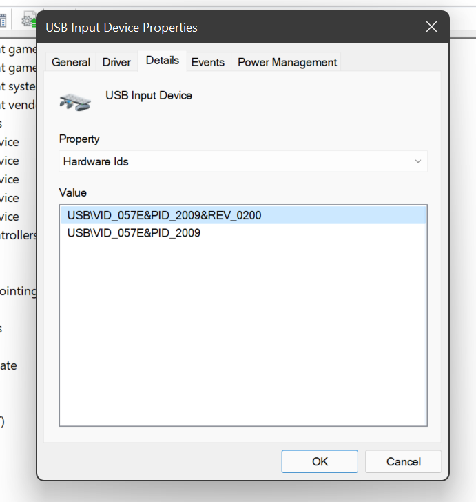

              To ensure that it is Switch Pro controller, you may check Hadrware IDs field, it should have the following VID:PID:

                Hardware ID almost matches your screenshot above.
                The issue persists.
                  Got it
                  Could you please specify which numbers you see? I assume you have different "REV" (revision), just curious which one.

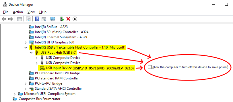

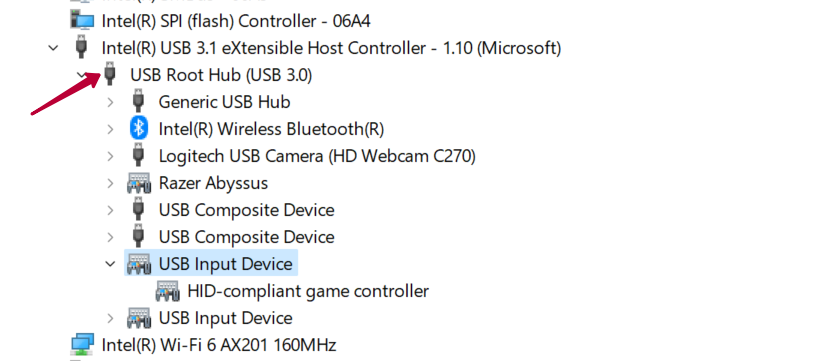

                  Also, one more thing: once you switch to the View by connection (as I can see on your screenshot), please check the parent devices of USB Input Device — they also may have Power Management settings. Turn it off for all of them including USB Root Hub:

                    USB\VID_057E&PID_2009&REV_0210

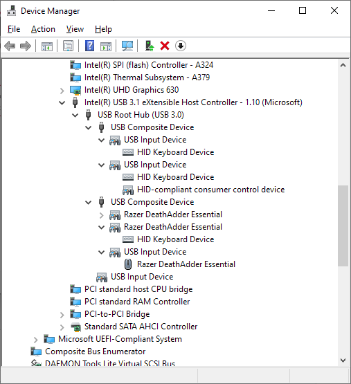

                    Still having the issue.

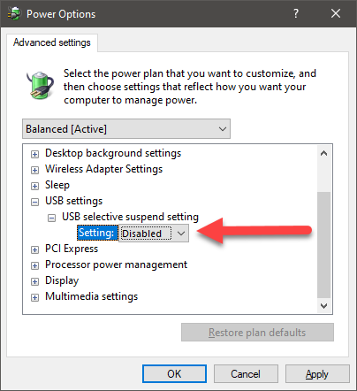

                            There might be one more way - to disable USB selective suspend. To do that open [Control Panel] > [Hardware and Sound] > [Power Options] > [Change plan settings] (of the currently selected power plan) > [Change advanced power settings]. Then find [USB Settings] > [USB selective suspend setting] and set it to [Disabled].
                            PC restart might be necessary for the setting to apply.
                              I've attempted disabling USB selective suspension. Still cannot make input without unplugging and reconnecting after Windows startup.
