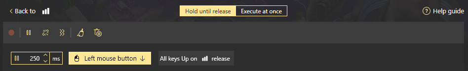

    If you want to make a [Combo] that would press something with a delay, and do nothing if the trigger was not in the zone long enough, try making a combo like this:
    Note: this kind of combo will not release the last key/button before you remove the trigger from the remapped zone.

                So the issue here is that you are getting into the high zone almost every time, and thus want for [High Zone] not to trigger for the first time from the moment when trigger is pressed. Unfortunately, [Combo Break] does not fit this case and reWASD does not have any means to provide a solution that would not rely on your accuracy.
                So if you insist on using zone mappings, you will ether have to train your finger to be able to avoid the [High Zone] when you don't need to trigger the "change zoom" action, or to set the combo I've presented in the post #2 to a [Medium zone] and adjust its size and the first pause of the combo to be just enough to always register your "brief release and push back" movement while not registering your first "full trigger press". Though that will still rely on your timing, accuracy and stability of FPS in the game. Otherwise I can only suggest to set up a [Shift] with [LT] as a its modifier, change one of the buttons you'd be comfortable with to "change zoom" action on that shift and use that.

                  Hmmm, well it wasn't what wanted but it's definitely what I needed. Your timed combo solution is working excellently. I shortened it a bit but other than that it's perfect. It's really fast, requires the tiniest of movement, I get to consistently choose which zoom level I want with virtually zero error, and the technically lesser-used zoom level corresponds with the technically longer pull time. If you can call 150ms a "long" time. Hard to argue with the results.
