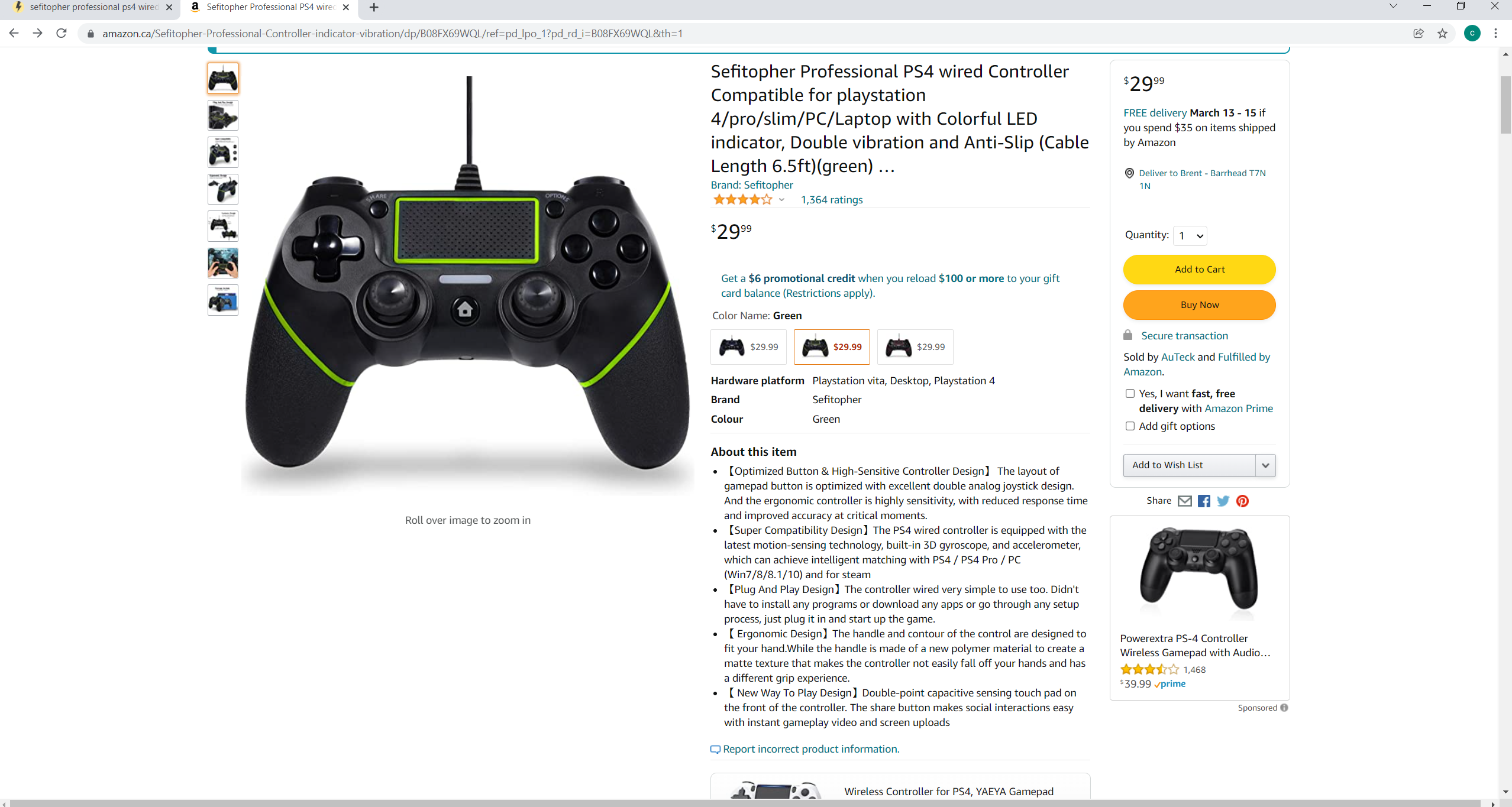

sefitopher professional ps4 wired controller

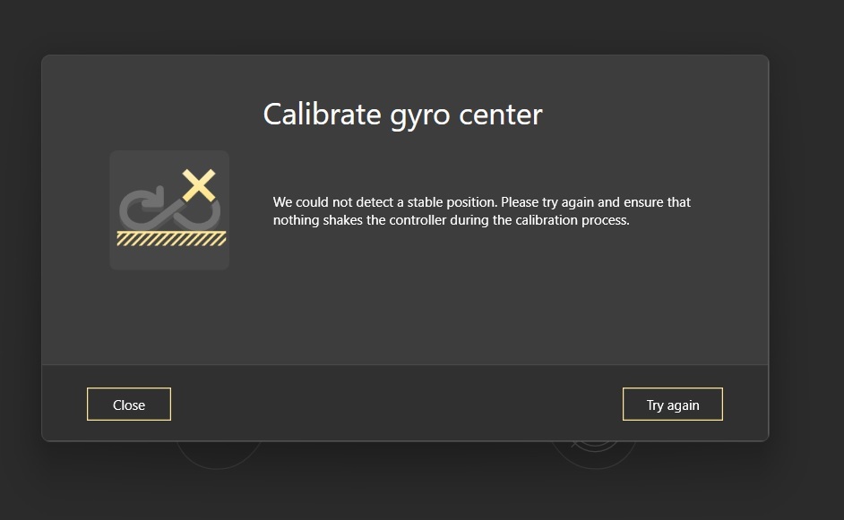

        i can't manually calibrate the gyro settings. do you think this gamepad is just does not have a gyro in it. Amazon said it has gyro. Click image for larger version
          here are some more screenshots. when i disable the xbox360 controller it turns into a ps4 controller but the gyro can't be emulated the way its done here.
            Please send a link to your controller.

                In order to calibrate the device's gyro, please try the following: disconnect the gamepad from the PC, connect it again, leave the gamepad on the table and wait 3-5 seconds for the autocalibration. Then, try to apply a config again. You may not switch to the manual calibration in reWASD — it should be OK with the automatic one.
