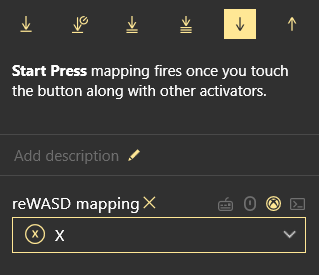

      My settings where just this:
      But now added Start Press as well. And did the trick! Thanks for the tip.

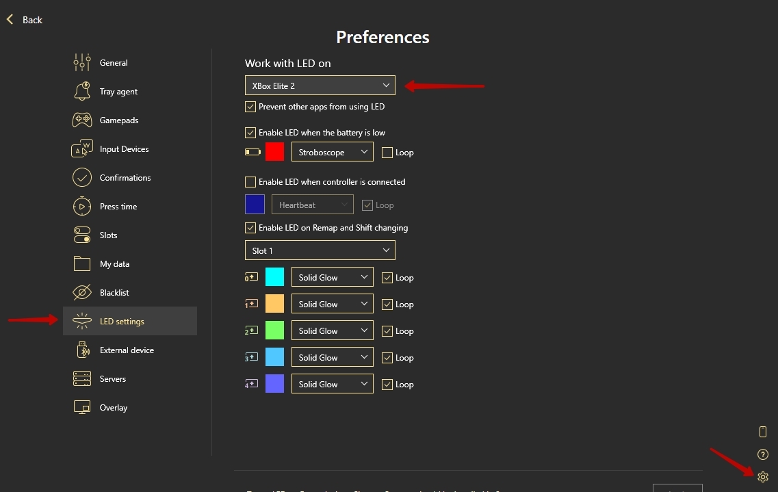

        Also send a screenshot of your LED settings.
          Sure. Removed the IcoGame.png images from zip to save space.
          Did try just about anything. Like leaving "Enable LED when controller is connected" ticked/on and only use none and the other way around as well, but same result, controller will just turn on light again after reconnecting. A General > Clear Data do make the light turn off after setting the settings again, but just back after reconnecting next day.

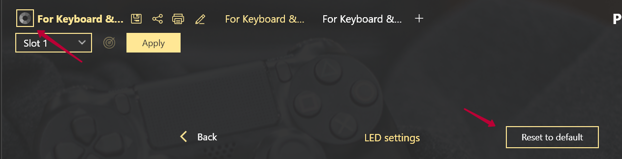

            In your PS4 Remote Play config, the LEDs are turned on. You should reset them to default — because the LED in config always overrides the settings in Preferences.

            Also, it may be a chance the controller sends LED by itself. To override it, you do not need to turn the setting off, you need to apply black color to them.
