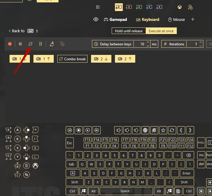

    Hello! If you want the button to change after each click, then use a combo like this:
    With a combo break, the combo will stop reproducing after each break, and continue once the button is pressed again.
      Amazing.
      Thanks so much.
