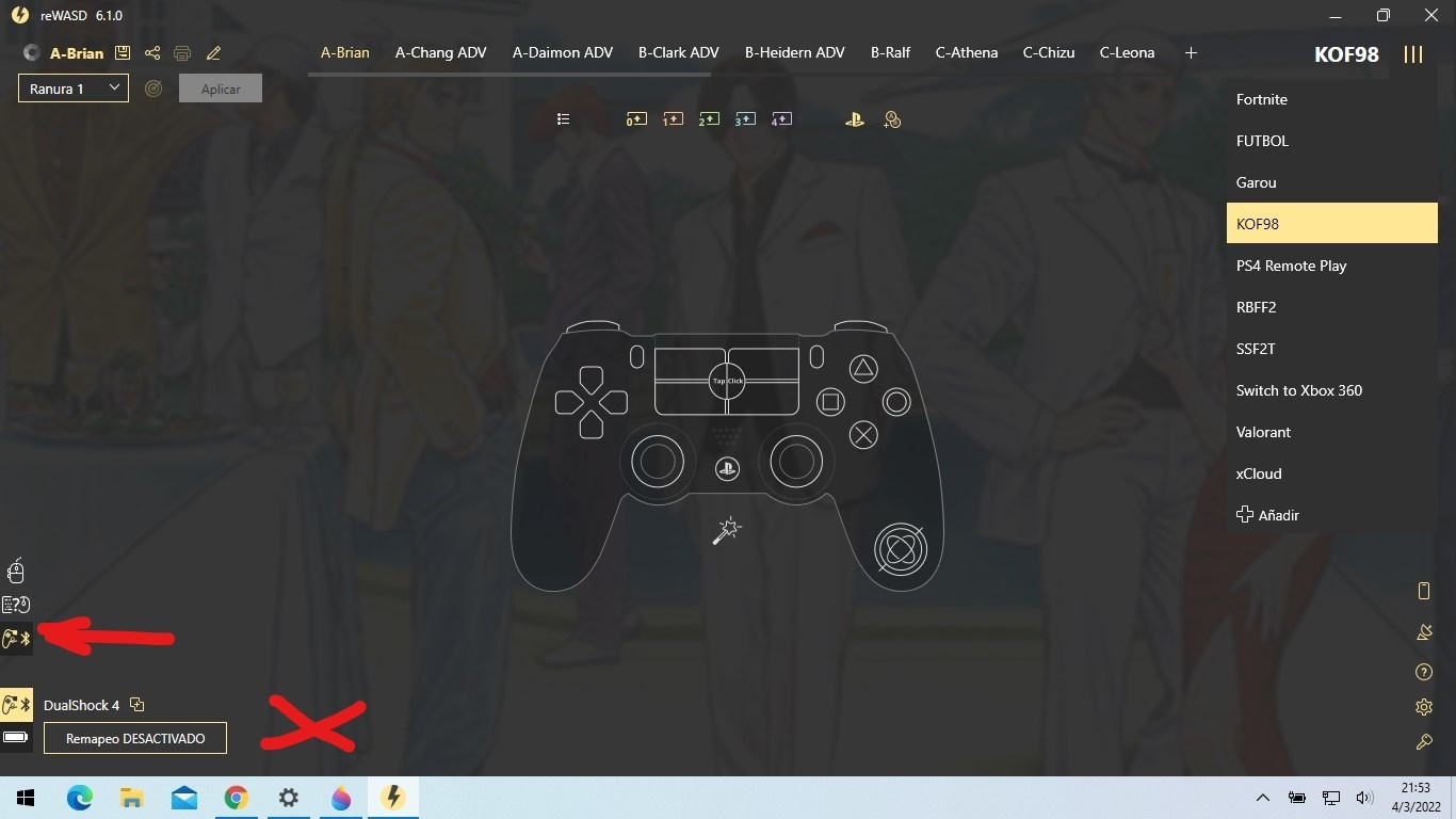

    When I update to the latest version (6.1.0), I can't activate remap using a DS4. Using a USB connection, it detects it correctly, but it doesn't let me access the option to "activate remap" and it doesn't show me the games profiles configured in the previous version (5.8.1).

      Hello!!
      I started having this problem since version 6.0.0
      I'll show you what I say..
      DS4 with usb cable (6.1.0)

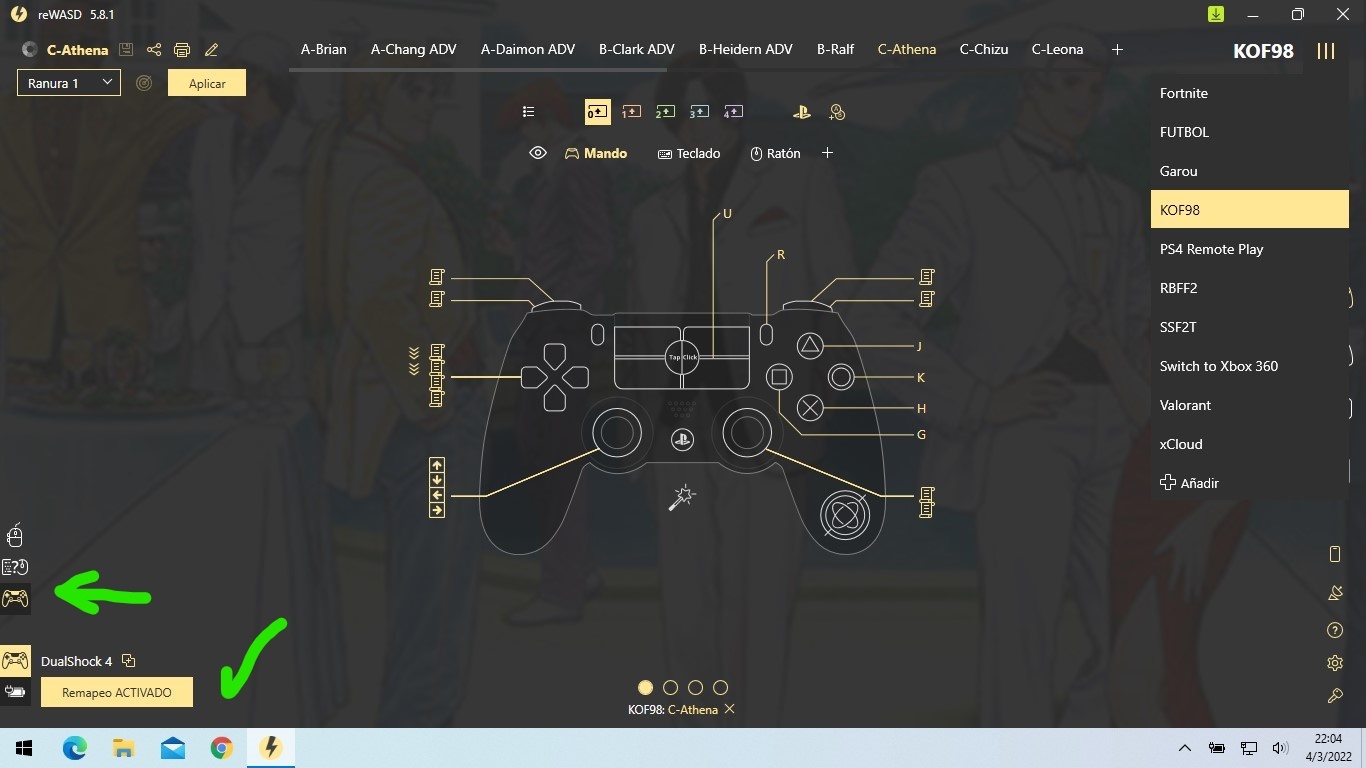

      DS4 with bluetooth(6.1.0)

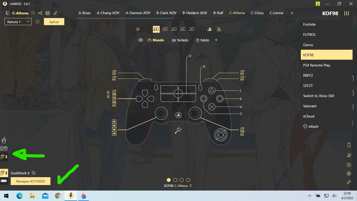

      DS4 with usb cable (5.8.1)

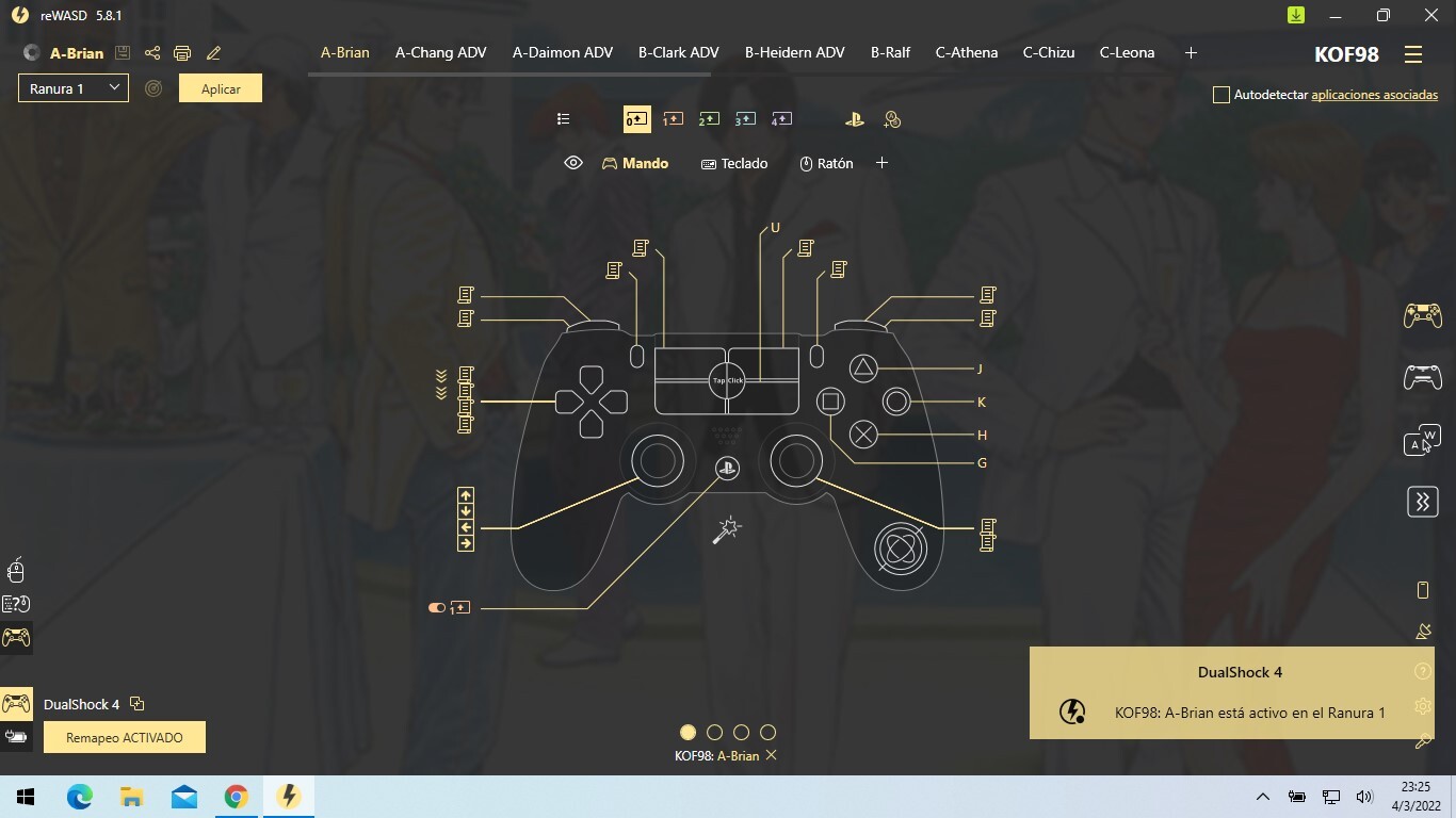

      DS4 with bluetooth(5.8.1)
        We see that you are using different configs on these screenshots.
        [A-Brian] config seems to be empty, which is why [Apply] button is disabled.
        [C-Athena] config has mapping on it, so [Apply] button is available.
