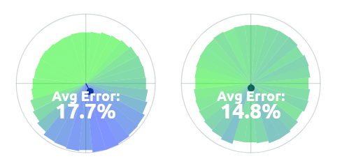

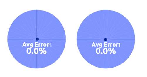

    since yesterday the joysticks of my Switch Pro Controller are not fully functional. The joystick range is way off (left stick) and to low (both sticks). I tried the Windows controller calibration, but it didn't work. In joy.cpl they are fine and working normally, but in games it ignores the calibration. In USB mode they are totally fine, so it's definitely not the controller with some kind of drift.
    I also tested my DualShock 4 which is working flawless in USB and Bluetooth. I tried BetterJoy which is another tool for XInput emulation for the Switch Pro Controller, it also was working correctly.
    So the problem seems to be reWASD. Any ideas how to fix this? (I know I could change the response curve of the sticks, but sadly that is not fixing the offset of the left stick.)
    gamepad-tester.com results:
    Bluetooth

    USB

    Hello all!
    Please re-download the latest build from our website — it includes the fix for the mentioned issue.
      I sent you a special build in private messages that should help with this. Install it and check if everything is ok now.
        Wow thank you very much, this totally worked! You guys are great when it comes to support. I'm really enjoying reWASD.
