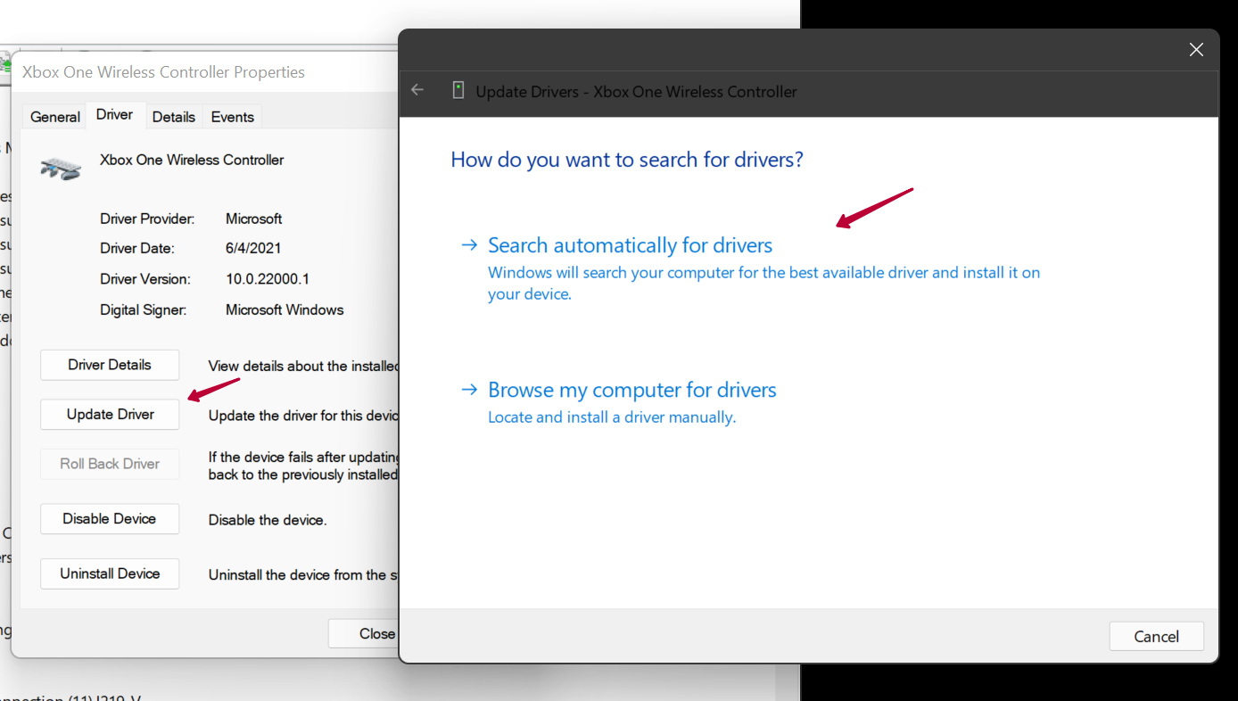

                Thanks reWASDer for your response. I tried to select that driver but it was unable to save the settings. I tried to uninstall the driver and restart my computer and now it shows as HID-Compliant Game Controller in Device Manager. I tried to update but receive the same error message. Any insight into this one?
                  Please try to search for a driver via the Internet using this option:

                    RAM Stealer I have exactly the same paddle issues as described by harvspecial. Also on Firmware 5.13.3143.0. I tried reverting via the Device Manager trick above as well as a firmware reinstall after uninstall from the Internet (as shown directly above) and couldnt get it to revert. I don't have access to a console for the other technique to revert. I guess I'm stuck until MS fix this new driver? Or have they permanently changed the way paddles are registered with the new drivers?
                      Unfortunately, these are all available methods so far. We hope that Microsoft will make corrections soon.
