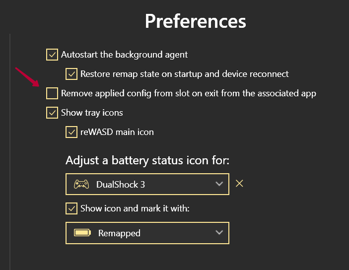

    Please go to Preferences ( at the bottom right) -> Tray Agent tab. Here, uncheck Remove applied config from slot on exit from the associated app option:
    After you apply the changes, your associated config will be applied once you open Explorer or something, but it won't be removed when you switch to the non-associated app.

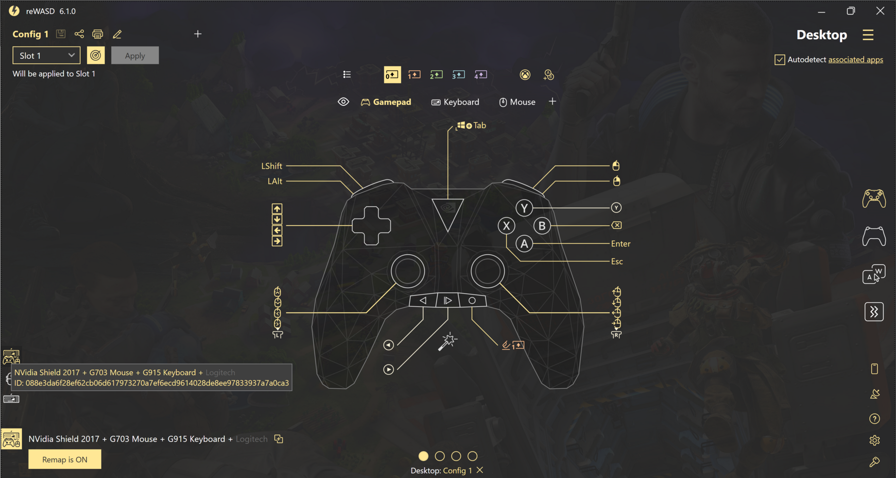

      As to your second idea/question, I'm not entirely sure what you mean. My config includes mouse, keyboard, and my gamepad, which I guess I am combining into a virtual controller. Here is a screenshot from inside my Desktop config, not sure if this is what you were asking for.
        Click on the "magic wand" and deselect the virtual controller so that no virtual controller is emulated. This should prevent the creation of a virtual controller on the system and, accordingly, the appearance of these system sounds.
