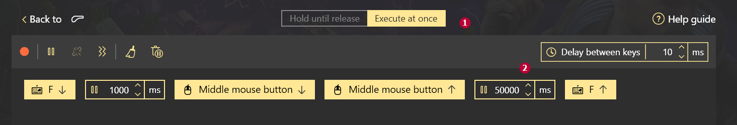

          1. Create a combo in Execute at once mode (1) which starts with F-down, Pause (1 second as you have mentioned), Mouse button click, LONG pause (2) and F-up:
          2. Set this Combo to Turbo:

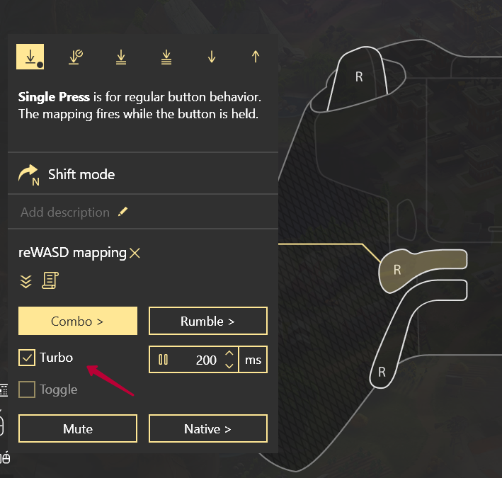

          This is how it will work: while you press and hold the paddle, you get the continuous press of F key, and also Mouse button will be clicked once after the preset pause (first one). The long pause lets you emulated the pressed F during al long as you may press and hold the paddle itself, while Turbo will stop the combo right after you release the paddle.

              You describe the behavior without Turbo. Have you tried to check it? Or maybe you do not have an active Rapid Fire feature? If you are missing it right now, please send me your System ID (which is shown on the License tab, at the bottom right), so I could add a few trial days for you.
                thank you for the reply, yes I bought the full version with rapid fire / turbo so I tried it and it worked. turbo should not solve this problem as far as i can tell and it is not apparent why it would, but seems to have done the trick. I just did combo like "f down, pause 400ms, m3 down, m3 up, pause 999999999, f up".
                the turbo allowed me to let go of the paddle and also stop the combo, where without turbo the combo will continue. strange the way that works, but it works so thank you for the idea!
                  We are always glad to help!
                  This is normal, because the turbo allows you to fire mapping while the button is held down.
                  And the combo itself is thought out so that it plays the sequence you want and continues to hold the f button for 999999ms.
                  But as soon as you release the paddle, the turbo stops working and the mapping (combo) will reset.
                    Yep, this is a trick Will try to make more obvious in the next versions.
                    Glad to know that it works for you!
