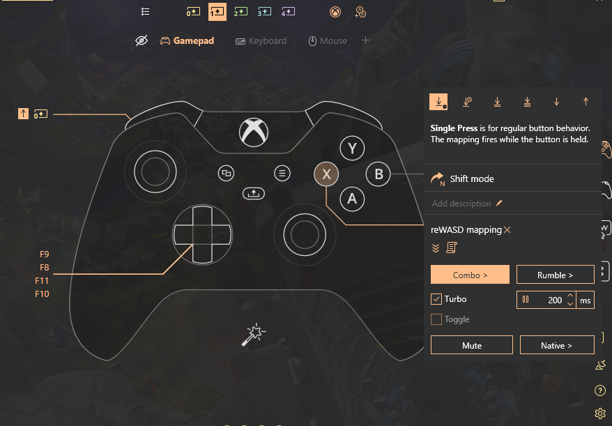

    When I use the Left Trigger and use the X button, it cycles once through the combo once and does not repeat. I have tried disabling/enabling apply and "Clear Data" that's in the preferences.

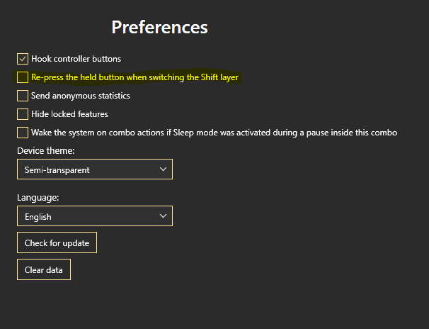

    Never mind answered my own question... Not sure if I had unchecked this in previous version or something enabled in new version?

    Hello! You are correct, if you uncheck this option, you will get back to the behavior you had in the previous release.
    Basically, while it is checked, the buttons pressed before you Jump to another Shift will be "re-pressed" automatically, so your Turbo from Layer 1 should start working immediately. If the option is disabled, you will need to re-press the button manually after your Jumped to the new layer.

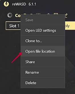

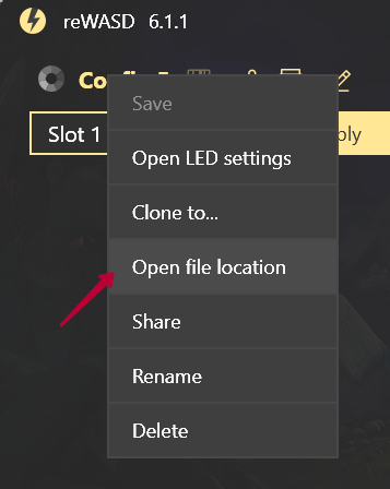

    Here is the easiest way to get access to the config file:

        Tried this config on our side and it seems to be working as it should on latest version (6.1.0.5615) - the combo repeats as long as you hold both [LB] and [X] with no regard to what was pressed first if the [Re-press...] option is enabled.
          Yup it's working, for my use I would normally just hold the trigger, then hold the X key and let go of trigger and let it run turbo while holding down the X key. I would rather not hold both keys.
