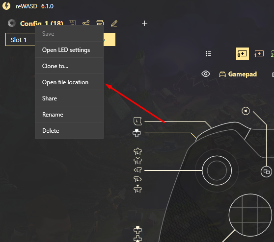

    Please send me the config you are using. You can find your config by right-clicking on the profile name and open the file location.
