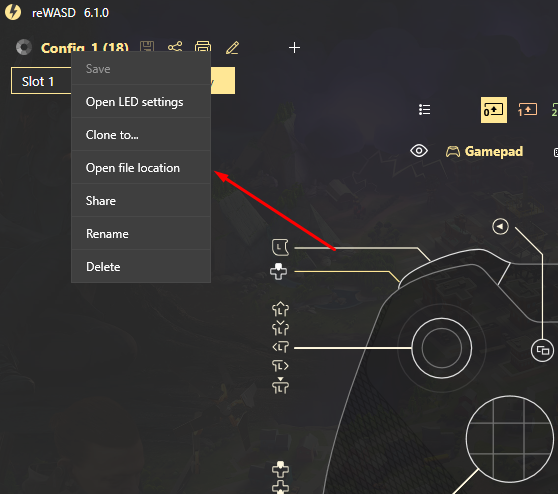

    Send us your config so we can check the shortcuts. You can find your config by right-clicking on the profile name and open the file location.
