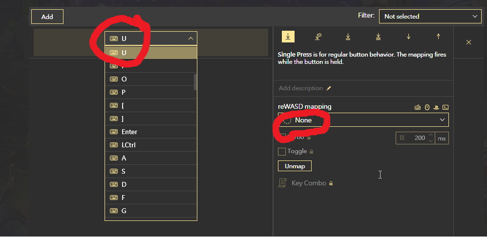

    This is simple keyboard remap , when you select the pull down menu on left and then press a key (eg U) it will jump and select U for you . which is perfect and logical, (because it is an active menu) the software mostly do it this way with other sub selection.

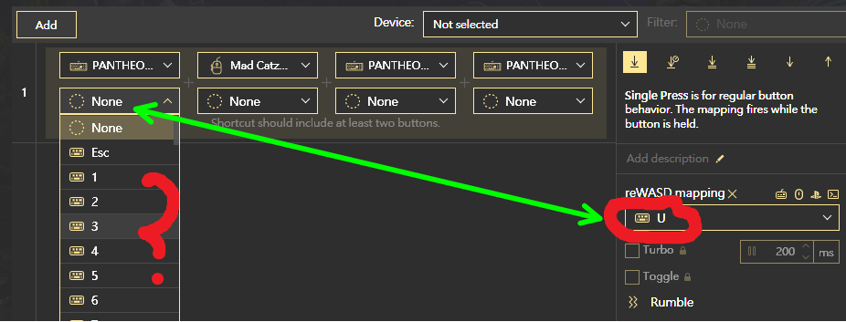

    This is shortcut mode with kb, if you select any menu on the left and press the target key U, nothing will happen but instead U will jump to the right menu (rewasd mapping menu... which are not active or selected)
    This is super annoying for many reasons. This bug is just waste of time and make me.........

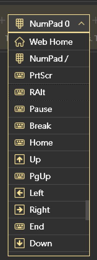

    Even i don't press the target key for quick selection and search the key slowly like a bobo through the pull down menu , guess what happen...
    The menu is sorted by alien order.... Numpad enter where are you ??? It is in super random order
    I don't want to play the find your key mini game everytime when i need a remap/correction .
    I don't care about the order of the menu , but plz fix the quick select for the active menu(shortcut selection or more)... thks.

          ? If it is not a bug why the right side menu (rewasd mapping) can capture the input of U and put it there?
          It should capture the U and put it on the left menu which is selected and active same as the first picture (the first picture is correct, the sec pic is shortcut mode)
          Or say it in different way
          1. it captured my input(U) and put it to current active input menu(left) , which is correct - general keyboard remap selection
          2. It captured my input(U) and put it to a no-active output menu(right), which is wrong.- shortcut selection
            Nevermind, I think it is a bug because if it (shortcut selection) is not hooked/captured, no menu(key) should be moved but it still moved in opposite(right menu).
            Plz take care of the double press time thing too... thks
              Sorry for the misunderstanding. The Shortcut panel doesn't let you use hooking option at all. It is not actually a bug because this thing has never been implemented. Yes, you can hook the keyboard keys in reWASD mapping section, but it is another control here. We do plan to add hooking for shortcuts, just can't promise that it may happen in the upcoming version.

                          Please check the latest version — reWASD 6.2.1. Now it lets you hook controller buttons and keyboard keys while adjusting Shortcuts. Set a focus on the left panel, press the control — and it will be selected.
                          Other novelties of the new version are described in our announce post.
                            Holy Ball , this is a great update. THKs team, the hooking are correct.
