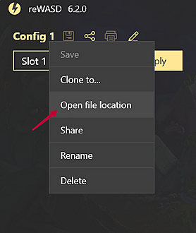

    Please send me the config you are using. Right-click on the config's name to open the contextual menu and choose Open file location. I will need the correspondent *.rewasd file.
      Dear.
      Why when pres to R1+Square then r1 common behaivor is running? please explain?
        In reWASD internal architecture, shortcut behavior may vary depending on which things are mapped to the shortcut. That is why would be great if you share the config you have, so I could find a fix faster.
        Here is the easiest way to find the config file:

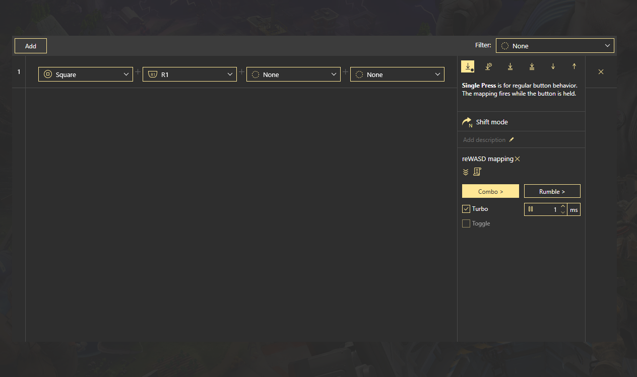

          Hi Again.
          I deleted all old combos.
          So, I tried to create new combos. R1+ Square like attachment. But R1 common behavior is running firstly instead of R1+Square short cut.
          How Can I fix this problem. I didnt see this problem in previous Rewasd version.
          Please check the attachments.

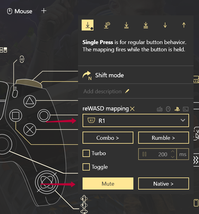

            Please try to remap R1, Square and any other button you are planning to use in a shortcut to its virtual analog and add Mute like I have here:
            It should help in your case.
              If I dont press to R1+Square, the R1 should be run as common behavior.
              how Can I do this?
                The button will be working the same way in this case, no worries. You just mute the native behavior and create the same behavior on a virtual controller. This way both buttons and shortcuts will be working as before. It is a temporary solution, we will do our best to fix this issue in the upcoming release.
