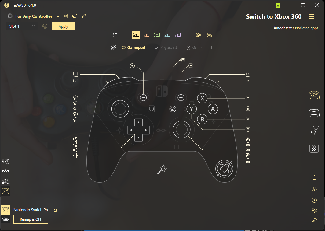

    So I use a switch controller, I think Rewasd was a brilliant solution so far. I'm not remapping generally but there's a bunch of games that don't really go with Steam's API not to mention emulators and such. Nevertheless a couple of games like Horizon Zero Dawn have completely stopped recognizing any input from the controller.
    When I switch to a regular xinput controller it works, any ideas? I can remap the controller to keyboard and mouse, that works but then I lose the analogs for movement.

      Hey there mate, so I don't think I have anything configured so far to be honest. Thinkg being the operating word. It feels like whatever rewasd did to the drivers to make the controller work on programs that normally would not work with it also made it unresponsive for certain games but I'm not entirely sure what it even does in the first place. Any windows specifically you'd like to see?

        Foremost, I would recommend that you update reWASD to the latest version 6.1.1
        You can do this by downloading the latest version of the application from our website, or by clicking on the green update button in the upper right corner of reWASD.
        I also want to note that Horizon Zero Dawn is compatible with Windows and PS4, and your config uses an Xbox 360 virtual controller.
        Therefore, try changing the virtual controller type to DualShock 4, then apply the config and test the controller in the game.
        To change the virtual controller type, click on the Magic Wand (1) and select Virtual DS4 (2).
